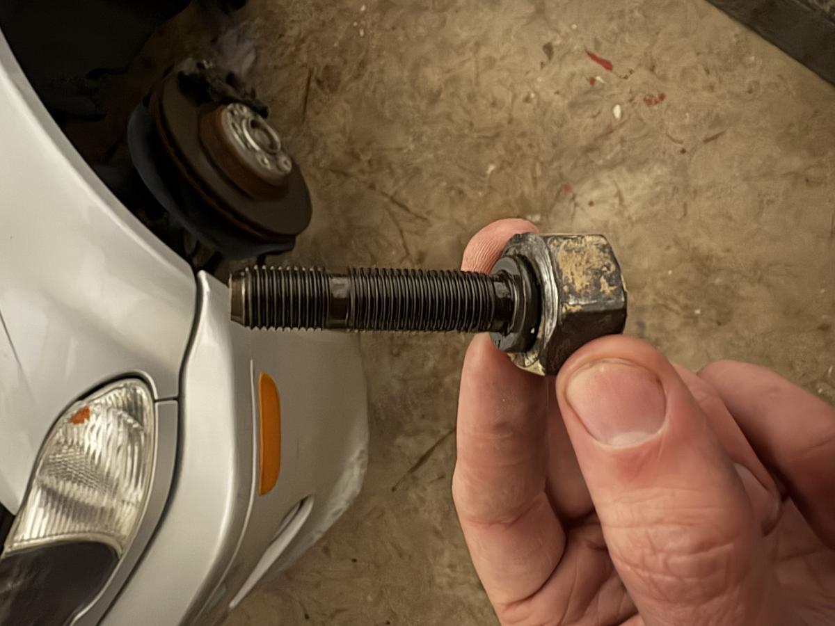

                    Finished the job today👍 went back and swapped out all the rod bolts for the ARP bolts. Everything with the subframe went back together pretty smoothly. The freezing rain has started here in Texas so I didn’t take it out on the road yet, but she idles fine. Didnt spot any oil leaks either, was kind of surprised!
