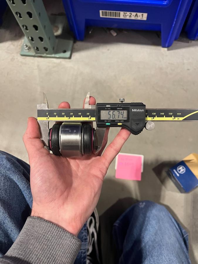

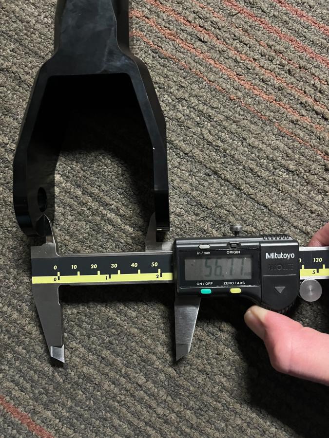

            ECS employee here. These are designed to be a very tight fit.
            I measured a set of our adjustable lower control arms (002608ECS01) and a Lemforder ball joint (33326775551). See measurements below - let me know how yours compare. My "flanged end" measurement matches our print and shouldn't present any issues with installation.
