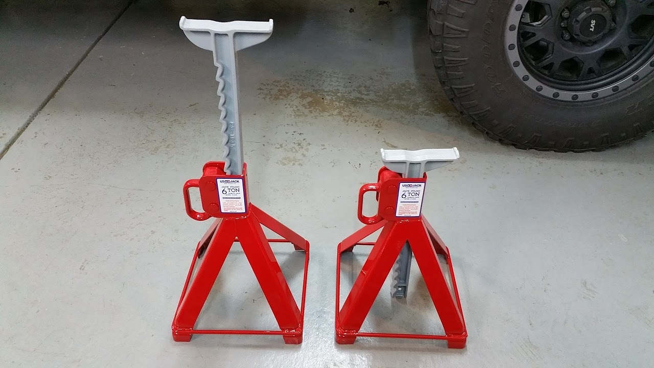

            MIL-SPEC stands from US Jack. Not cheap but either is your life. I also have a pair of the 3 ton and then I do use the 6 ton HF stands one at the center of each end of the M3 but at that point they aren't carrying much load. So yes, I use 6 stands anytime under the car.

            Click image for larger version  Name:	6 ton stands.jpg Views:	0 Size:	197.4 KB ID:	34759

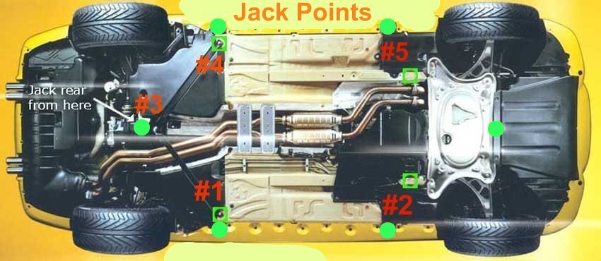

                  ok serious question, how would you jack up a car like that PY on the photo above. you drive on the ramps with your rears and then what? Jack would not fit under the car to reach the front jack point, do you need two jacks to do that easily? I've been working on my cars for over decade no and it is always a challenge...

                      The way I learned from the Bimmerworld guys is to jack up the car from the side. Using the picture below, it's jack point #2. Put a jackstand on the jack point #1, and the front jackstand on the frame rail (directly inside/medial to the forward side jacking point, so the green square by #2). Lower the car onto the two jackstands, then do the same on the other side of the car.
                      Downside I found with this method is the car will be resting on the plastic underbody panels, so you will need to somehow remove them first if you need access.

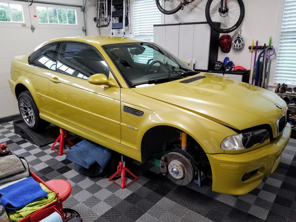

                        Sorry, the ramp in the pic probably confuses things. Not sure what I was even doing with those but think I had the rear sitting on them at some point. I do not drive up those. The car was up for an extended time doing various things over the winter.
                        Anyway, here's my SOP....
                        Jack under the front left jack pad enough to slide a piece of 2/12 under the front left wheel, repeat on the right side. With the front tires resting on the 2x12 blocks my low profile, long reach jack can then reach the front center jack point. Jack there then put the front on stands. Jack the rear from the center jack point and place on stands. Slide a stand under both center jack points, front & rear for extra safety.

                            I have a set waiting for go back to HF as soon as I can find some time.
