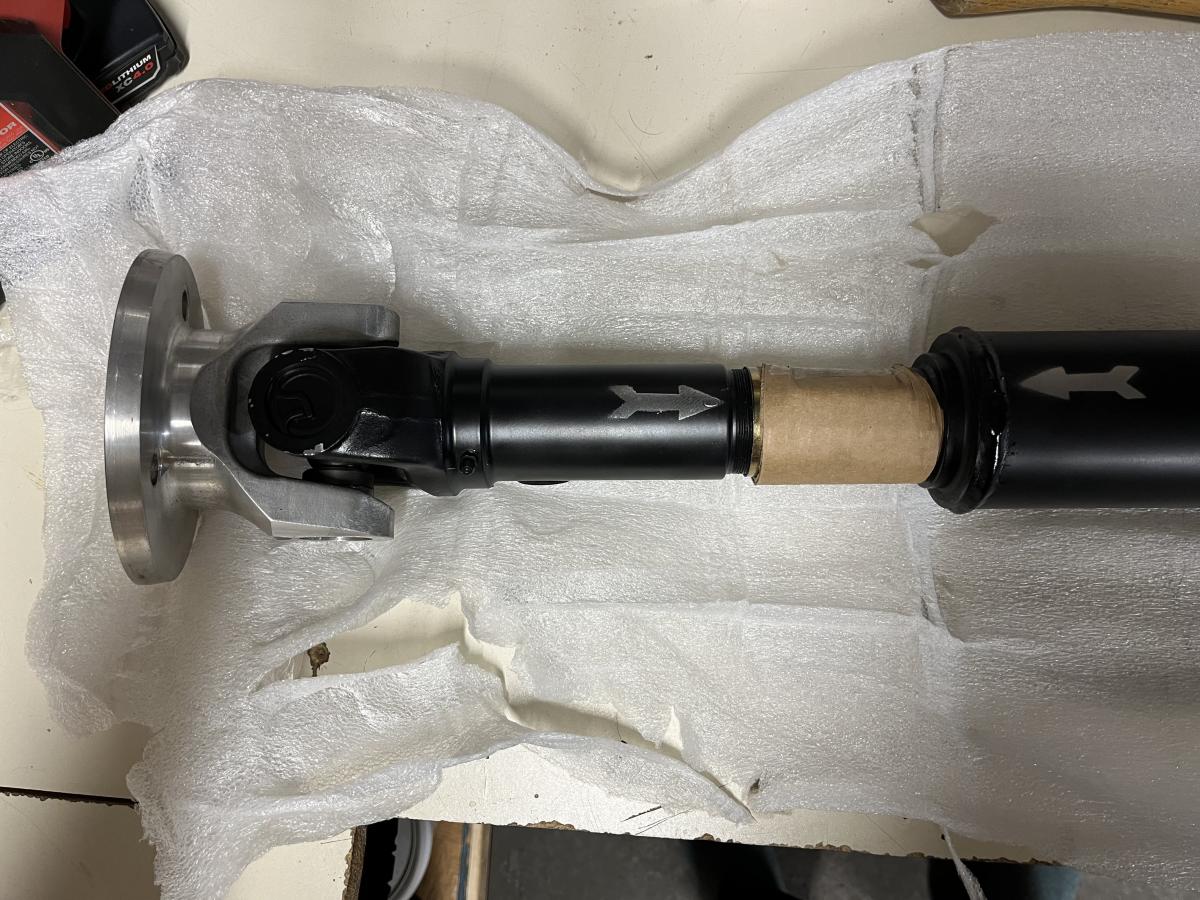

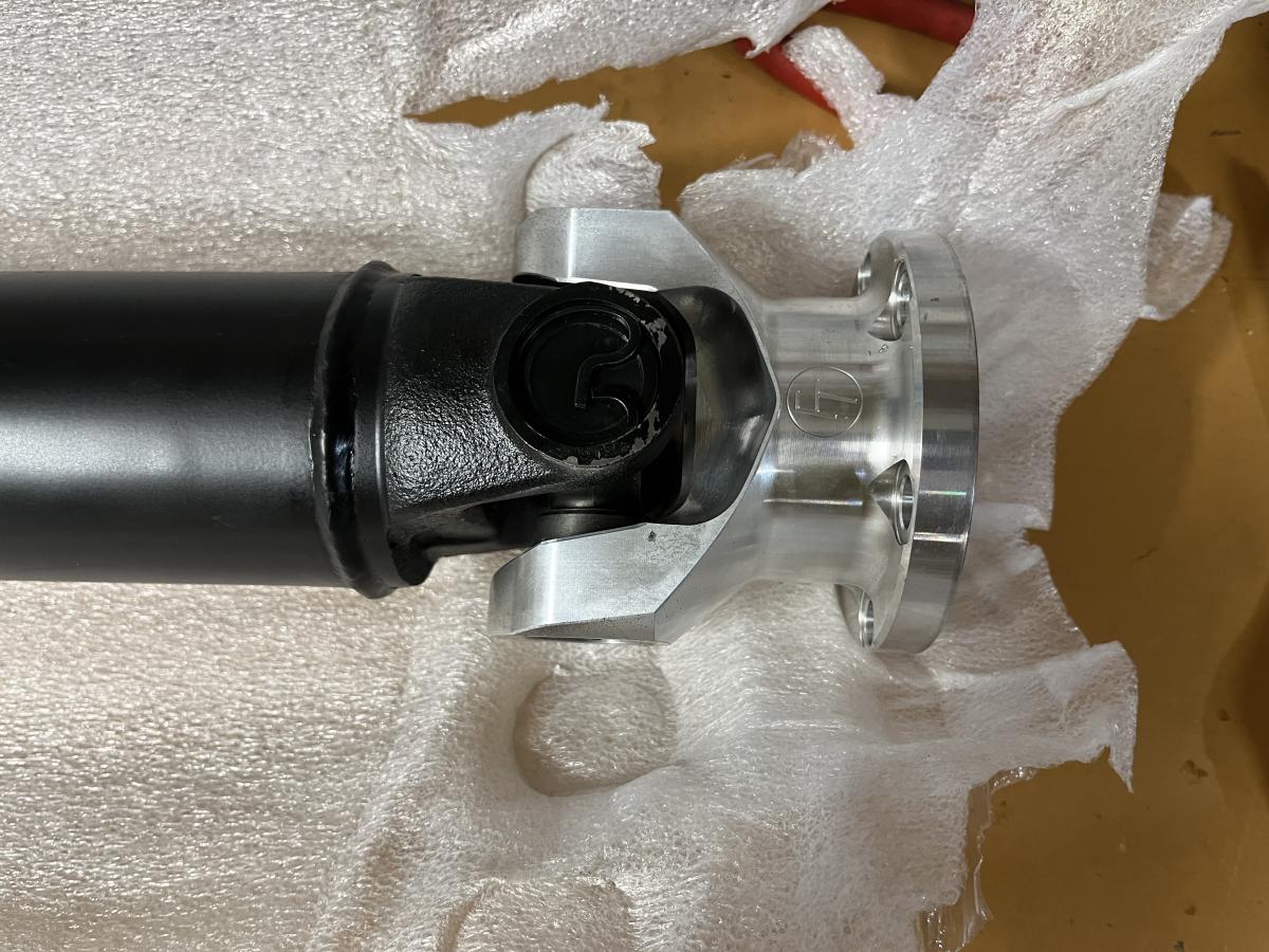

    Well, ive been chasing a vibration in my drivetrain and after replacing the engine mounts, trans mounts, guibo, csb, and rebuilt the diff, along with new diff bushings, and dont the subframe bushings, i am left with the driveshaft as my next thought for replacement
    As it turns out, a factory drivesaft is currently $2200 and a CF is similarly priced. I worry about the issues that a CF can have, so decided to stick with steel for $1100. There were a few options and i went with Full Torque because they were in stock and had free shipping. I dont have any knowledge about driveshafts beyond what a website says and they all swear theyve built winning racecars etc, so i took a chance

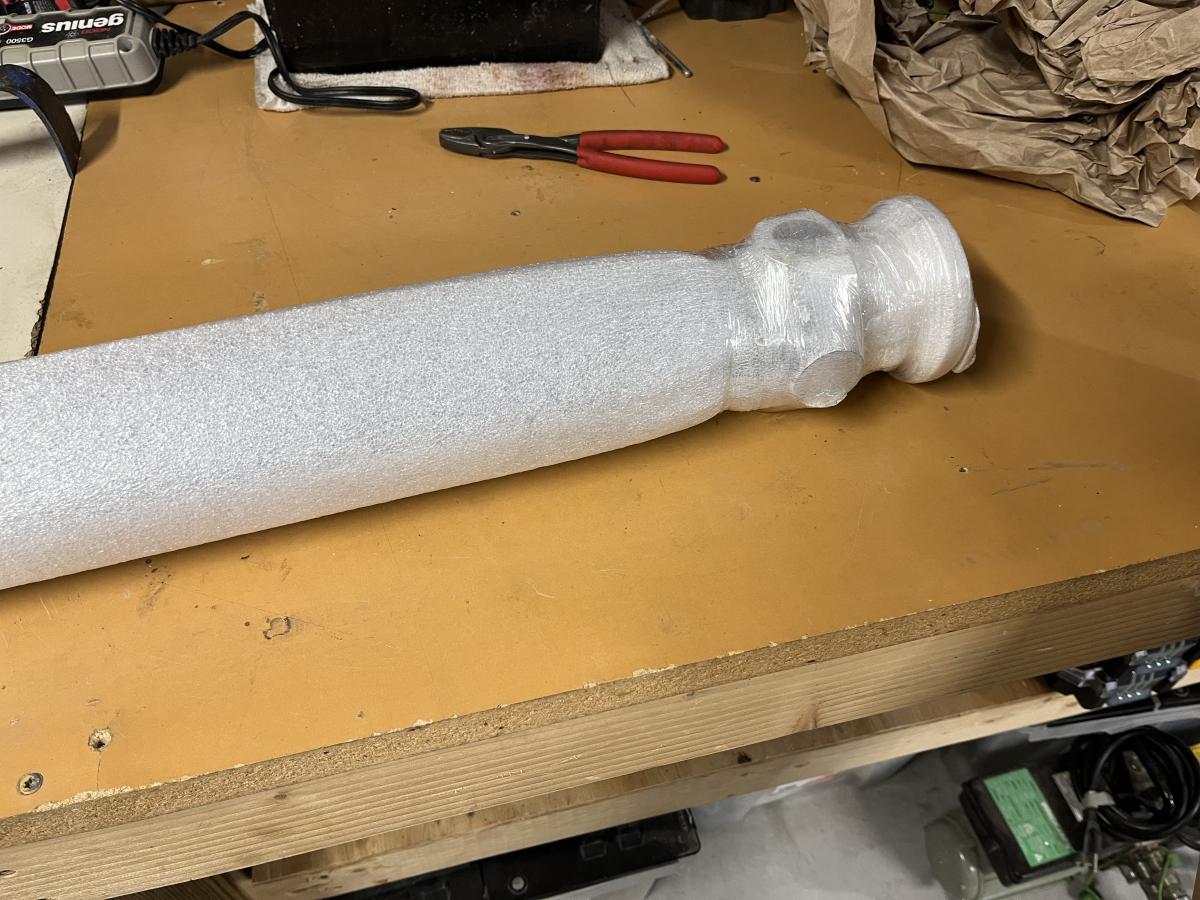

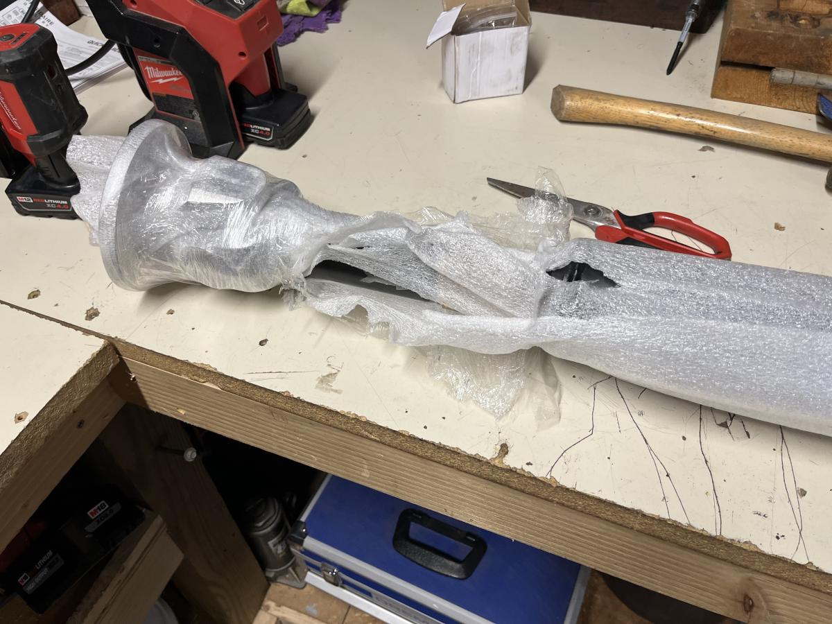

    First impression, it was wrapped well for shipping. Came with new hardware and its a very pretty piece. Appears to bolt from the trans to the diff, no more bushings to deal with. Once its finally not 10 degrees outside ill install it. But, figured id share it incase anyone else was looking for parts Click image for larger version

    Interesting option. This is an upgrade I want to do soon but I want greater weight loss vs the F80 driveshafts. Odd design with the cardian joints and a slip section instead of the stock CV. Can you weigh it?
    Curious to see if you have high speed vibration issues.

        Using the bathroom scale, it came out to 26.6 lbs.
        If i had to guess, id say they probably use those joints because they are in idaho and do more 4x4 stuff vs sports car stuff. But, i cant imagine they would want to put their name on something that sucks, so im hoping that i dont have vibration issues.
          Update for those that care: I installed this over the weekend. The bolts holes were not drilled quite right, so I had to slightly clearance the holes after talking with one of the builders at the company. He was very helpful and even FaceTimed me in order to show him what I was having an issue with. After putting the car back on the ground to go for a drive, I was getting a rubbing noise above 2k rpm. I thought it might be the heat shield, so I lifted it back up and made some room there. Went for another drive and it came back. I decided to let it rub a bit and see what I could find. Turns out, the rear u-joint is big enough that once you get a bit of speed going, it impacts the driveshaft tunnel. It was late on a Sunday when I finished, so I will address this with the company tomorrow.
          I will say, this is a bit disappointing, but I suppose that's a chance you take when you buy aftermarket parts. I am hopeful for a solution that isn't "clearance" the tunnel with a hammer, but I will have to wait and see.
