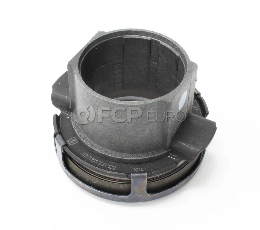

                        The reality is a lot of these manufacturers are reboxing each others parts. You'll often get a LuK clutch in a Sachs box and vice versa. If you look up the E46 M3 kits, you'll see both the Sachs branded kit and the BMW branded kit contain a LuK clutch
                        As far as the throwout bearing -- BMW supplies both versions. The Sachs version is what BMW provided for the E46 M3 from the factory and most cars from that vintage. There appears to be a high torque and low torque variant of the 'LuK TOB' which I think is actually made by INA. Not sure which one corresponds to what comes with the LuK kits
                        Sachs 21511223582 (E46 M3, Z4M, 325d, 325 SULEV, E39 M5, E6x 545/645 SMG)

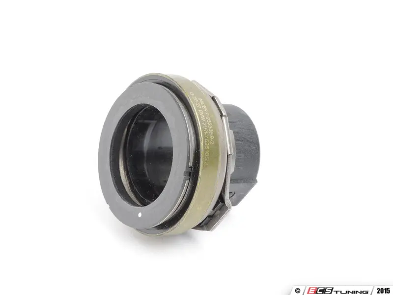

                        Luk - 21517521360 (M54b30 and similar / weaker)
                        Click image for larger version  Name:	image.png Views:	0 Size:	245.9 KB ID:	343211
                        LuK 21517526105 (E46 330d, E6x 545/645 and 550/650 manual versions)
                        Click image for larger version  Name:	image.png Views:	0 Size:	146.3 KB ID:	343212

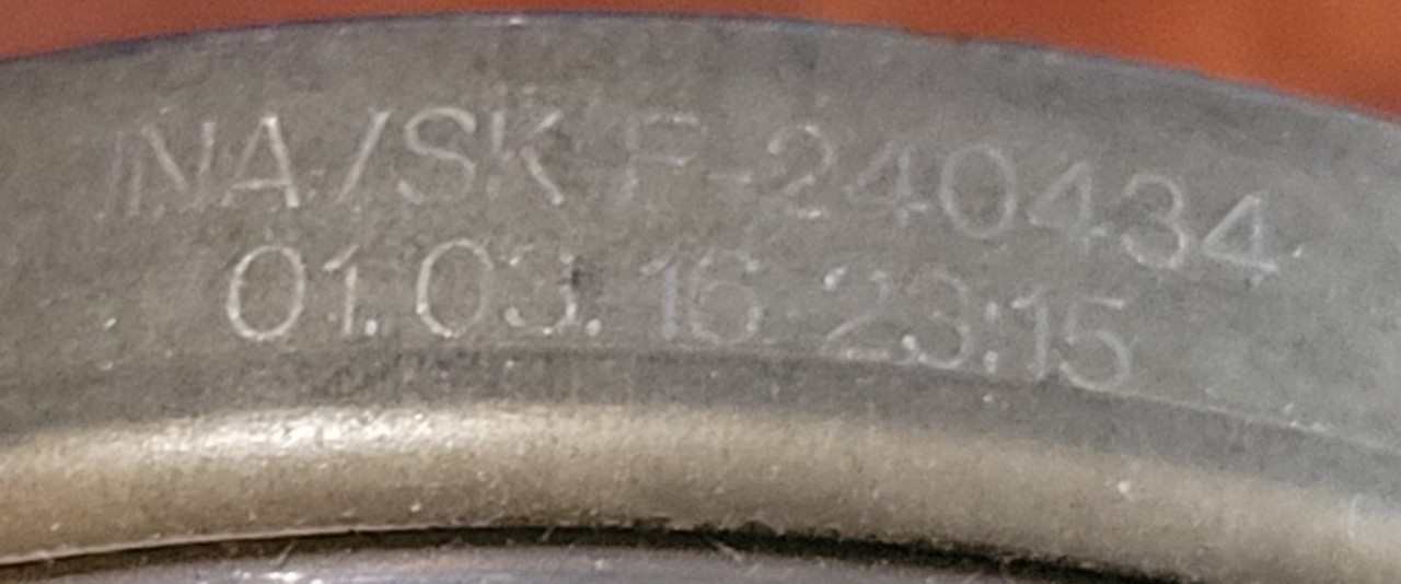

                          Here are some pics of the LuK bearing that didn't get fitted because i bought a Sachs bearing. Upon closer inspection it has INA/SK F-240434 etched on it with a date 1st March 2016. Interestingly the LuK clutch kit was purchased only 18 ,months ago max.
                            Tbh INA / SKF are top tier bearing manufacturers in general. None of the BMW branded versions of the bearing seem to have that exact part number, but at least as far as aftermarket goes, the one sold for E60 M5 / E92 M3 throwout bearing (21517548396) seems to match.
                            I wouldn't have many qualms about trusting the bearing honestly

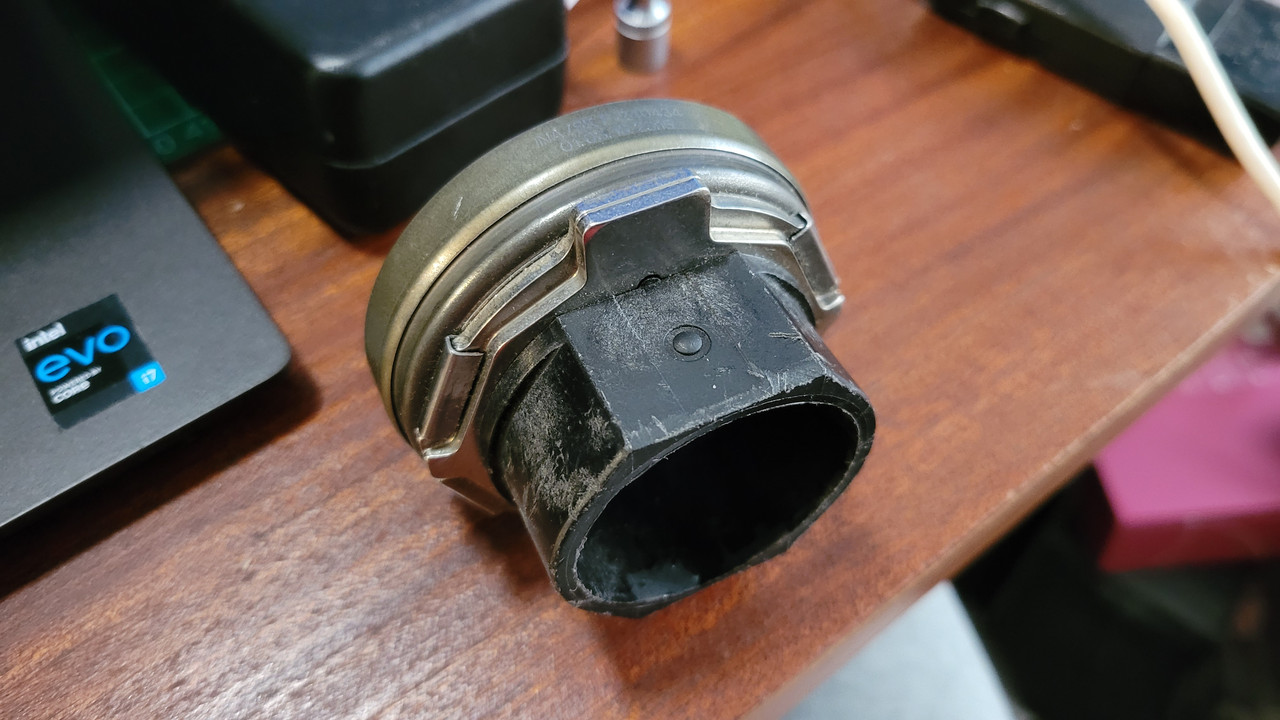

                              This is a genuine BMW M3/420g TOB
                              This one is out of an LuK 420g clutch kit
                              This is a genuine BMW GS6-37 TOB
                              And these are L -> R
                              BMW GS6-36, LuK 420g, BMW 420g
