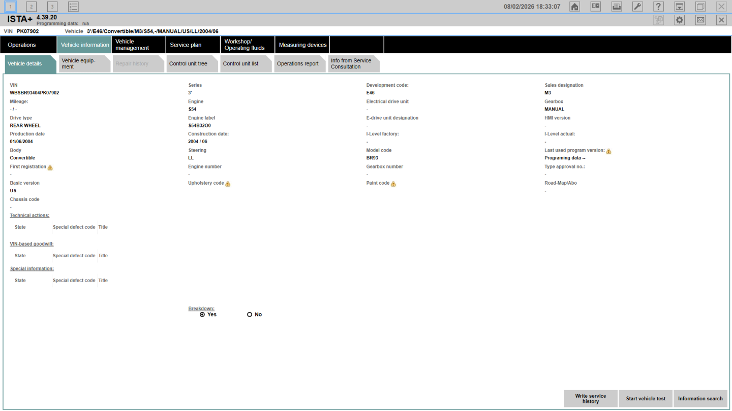

    What is your full VIN? I will check ISTA for you. Look for date stamps on the head behind the VANOS, on the VANOS itself, and anything else that would have been swapped during the engine exchange. My head and VANOS are dated '01'. Here is some info​

      Full vin WBSBR93404PK07902

        Well that was kinda annoying, i thought ISTA would give me the engine code without having to plug the car in, My bad
        I think M///Fanatic can assist
        Click image for larger version  Name:	EN.png Views:	0 Size:	121.6 KB ID:	342804
          The original engine for your car is 60243301
