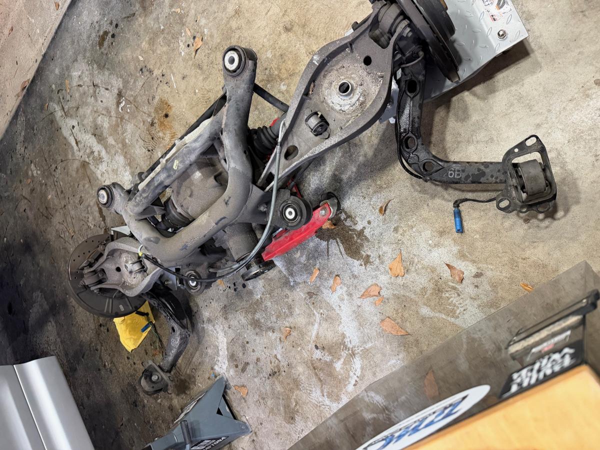

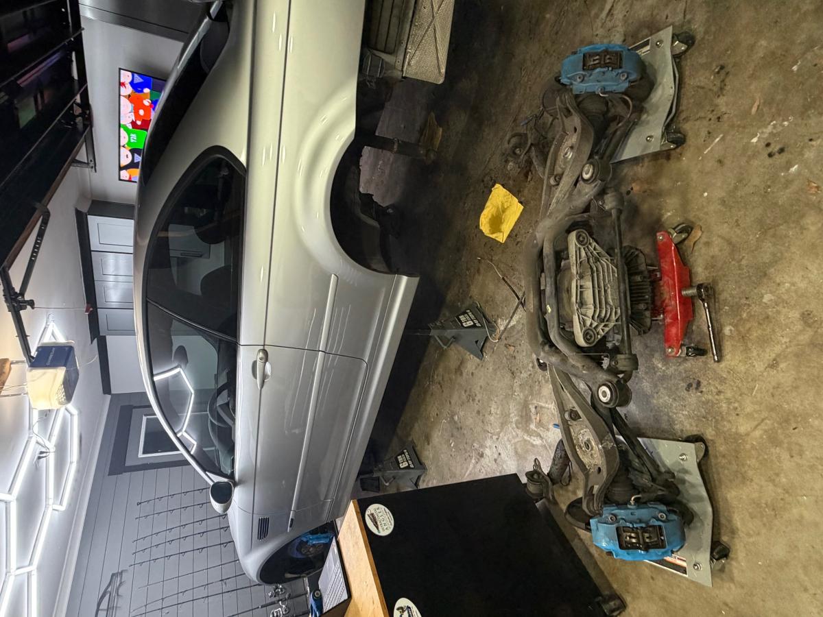

                            Well Ive got everything torn out.. Wound up going with the Turner control arms and adjustable sway bar ends, revshift poly bushings and reinforcement plates, ecs diff bushings, and turner mono ball rtabs.. I was watching some videos on pressing some of the bushings and just went ahead and ordered the Schwaben tool from ecs too. $100 for that sounds easier than finding random objects around the garage to use.. I've got a 12 ton press at my shop so I can take the parts over there if need be. Well see how good the schwaben tool does in the garage with an impact first. Just ordered a new fuel pump and fuel filter just for the hell of it as well.
