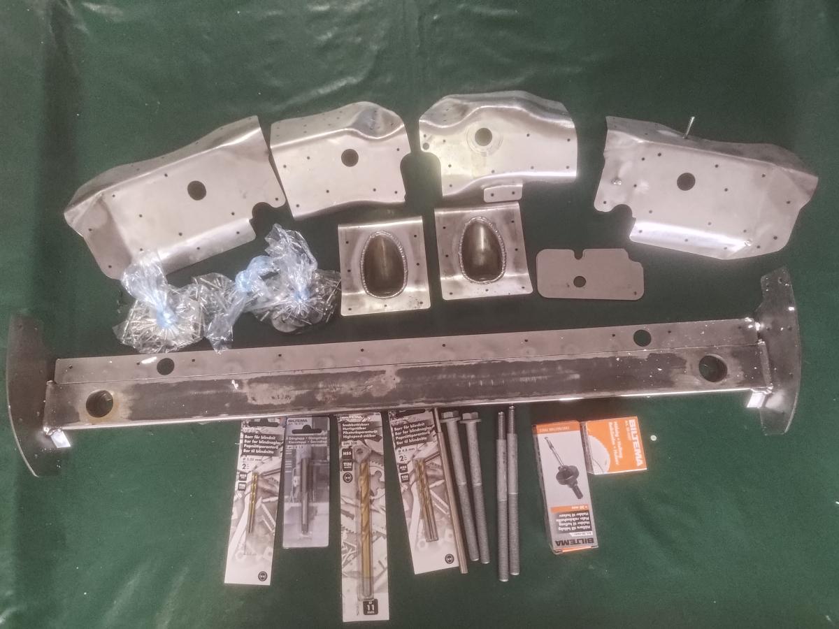

    My full catalogue has arrived, and it was worth every cent! The package arrived promptly and safely all the way down here in Australia. Tip-top service—Vince went above and beyond with both before- and after-sales support. Highly recommended!
    As you might know from my other posts, I haven't installed it yet. I’m still hunting for a new panel (mine has a gap rather than just a crack) and I've been busy trying to track down an oil leak
          Click image for larger version Name:	P_20260214_150949.jpg Views:	0 Size:	115.5 KB ID:	343354
          Thank you very much for sharing the video and thanks for your kind and appreciative words!
          please let me know if you need any help or advice on the repair and installation.
