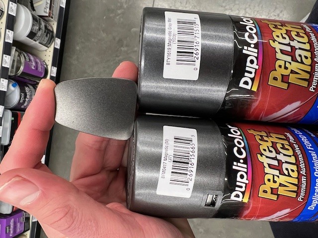

    I was just doing the same but didn't see BGM0522; I was torn between BFM0417 & BTY1619 so ended up not getting neither. Now I have to check out a third option? haha

      Yeah I noticed it even though you can get Dupli-Color from all three of the parts stores like O'Reilly's AutoZone advanced etc .. getting certain colors is hit or miss. They don't always care the same colors between the different stores.
      If There's an O'Reilly's around. Might want to give them a try. Use their website to check inventory stock. It's usually pretty accurate
