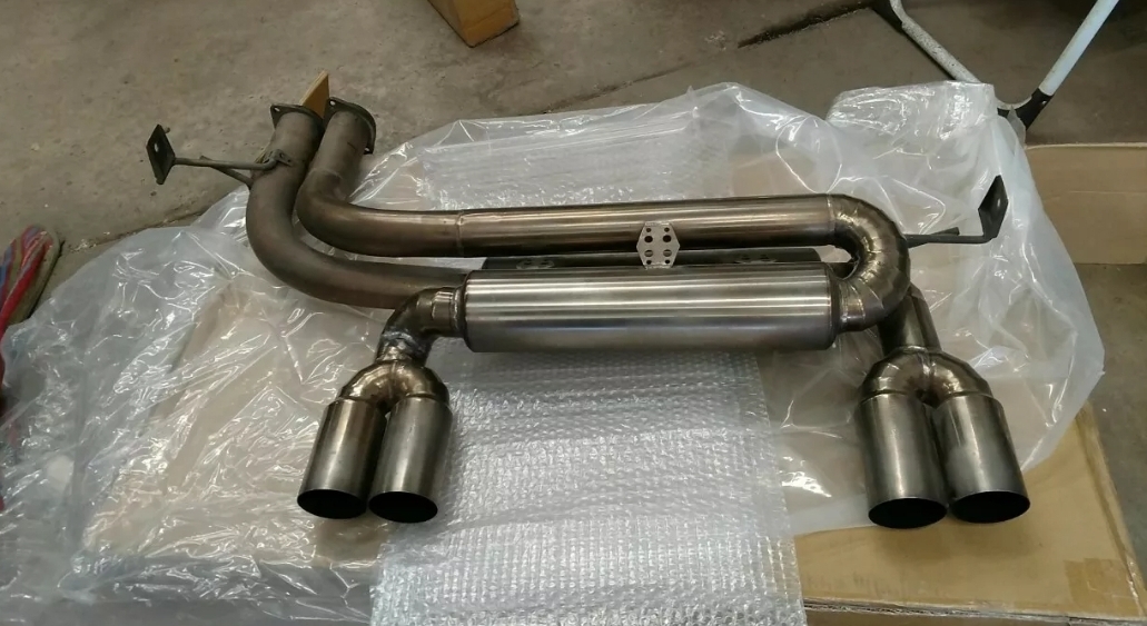

    Friend of mine is curious if this is a real titanium gruppe m muffler. I know there were replicas out there back in the day when these came out. Just wondering if anyone else would know if this is a genuine titanium gruppe m or a replica.

    Based on the condition of the metal (no rust and appears to definitely be titanium), the 30 pie cuts and welds, and the fancy drilled ltw hangers and brackets, it looks to be the real deal
    - https://www.evasivemotorsports.com/s...RoCqK4QAvD_BwE
      Get the serial number. Every real Gruppe M part has a different serial number. The reps of these all had the same serial numbers.
      2005 BMW ///M3
      Black6MT Daily
        The replicas were known to be great quality as well. They go for only a few hundred less than a genuine one generally. The first tell tale sign is the weight. It should around 11 pounds to test if it's aluminum. The serial number is also known to fall off. I'm pretty sure I have an authentic one but the serial number fell off. One thing I will note is mine has blue tips and the titanium has a more bronze color when it's heat cycle a few times.
        I called GruppeM and they were helpful in helping me figure everything out the best they could. Call them and ask.
