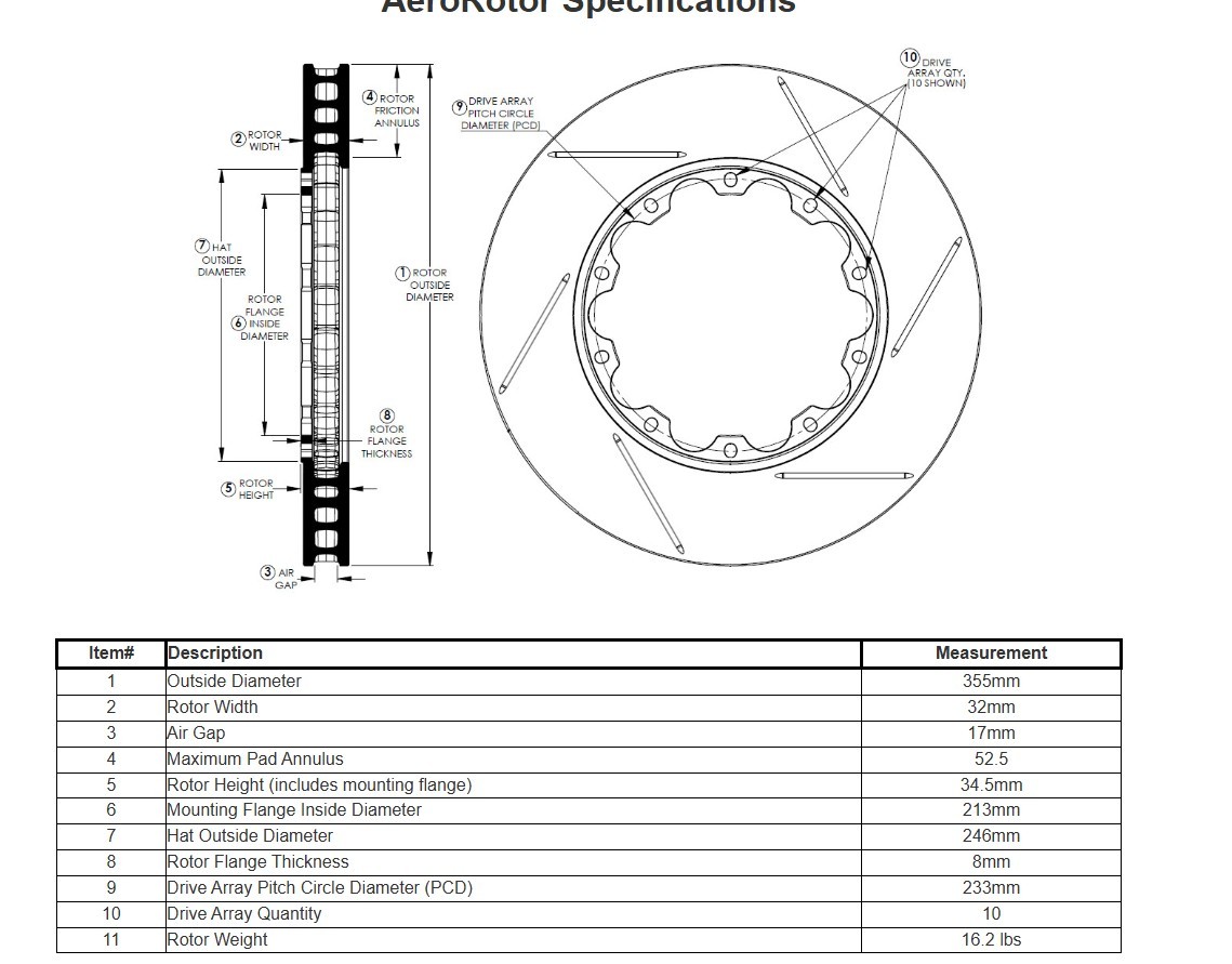

    I have a Stoptech ST40/355mm BBK, possible to get a CCB replacement? Assuming it needs to be the friction disc and the hat.
      #32
      Absolutely. I assume you would need pads as well but I can supply everything needed. I mentioned it on Rennlist but BBKs can sometimes be tricky because the databases I use to get OEM data from won't have them. That said, if you have any of the schematics for the BBK (2d rotor measurements), or are able to measure a few things, I am happy to make it happen.
      Let me know if you want to go into a bit more detail. Might be easiest to email me ([email protected]).
      Almost anything is doable though.
        #33
        Yes, also need pads. I have an old friction ring that you could have to do the measurements. Would that work?
        i know Stoptech had drawings on their website...I'll see if I can find them somewhere else. Maybe Zeckhausen.

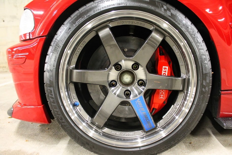

            Remember these bad boys - StopTech 14" F/R Carbon Ceramic Rotors (1 of 1 ever made for E46 M3) 355x32mm(rotor and hat combined weigh 9.6 pounds - 9.4 pounds less than stock)
            w/ 6 Piston Front (ST-60), 4 Piston Rear (ST-40) Calipers installed by Zeckhausen Racing and msweet
            Only a cool 15k in '07
            ​https://forums.speedlife.net/t/muaha...ant-wait/35282
            Click image for larger version  Name:	IMG_7244.jpg Views:	4 Size:	161.2 KB ID:	346046
            Click image for larger version  Name:	images?q=tbn:ANd9GcQ6lM-K4hJByNl3syoGQTZ5TVGXYv5pKh4Krg&s.jpg Views:	4 Size:	13.5 KB ID:	346047Click image for larger version  Name:	images?q=tbn:ANd9GcR2xTcMpnX_P2Fj53UwH5RXMo4Nlg2B8tz0gQ&s.jpg Views:	4 Size:	15.0 KB ID:	346048Click image for larger version  Name:	images?q=tbn:ANd9GcSWm-U71FOSkNOrTfZLnfJIwsHGeff5qxGTqw&s.jpg Views:	4 Size:	15.6 KB ID:	346049
            We’ve known for a long time that StopTech was developing a carbon ceramic rotor option for their big brake kits. Last month, the 700hp Callaway C16 Speedster was introduced at Pebble Beach and it featured the new StopTech ceramic brakes. Our turn to try these came just two weeks later, when we received a set for evaluation on a BMW E46 M3. This is a very big change in technology. Rather than using chopped carbon fibers, it’s made from a continuous fiber. This makes the StopTech rotors stronger than ceramic offerings from companies like Porsche, and less prone to oxidation - meaning they are more track friendly. We received four 355x32mm carbon ceramic rotors, mounted on billet aluminum hats and special brake pads in street and race compounds that are compatible with the exotic rotors.
            First impressions out of the box? These are very strange looking rotors. They weigh only 9.6 pounds (including hats and hardware) and they don’t feel real when you hold them in your hands. They feel more like those plastic rapid prototypes that you have made on a computer controlled milling machine to see what a 3D version of your product is going to look like when it’s done. But these are the real thing and they are supposed to stop the car! Of course, the first thing we did was weigh them.
              Only a cool 10k in '07
                                Does this work?
