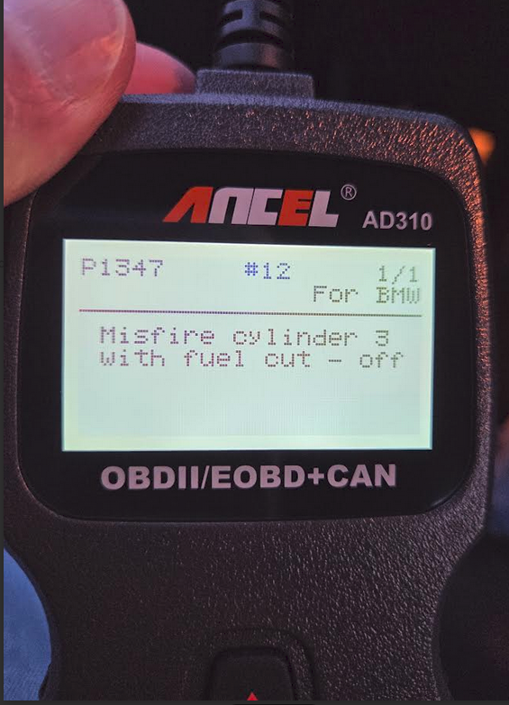

                So just wanted to give another update. Took the car for another spin tonight and gunned it on the highway and sure enough the car stuttered again, this time the check engine light is sustained. Pulled over to the side and scanned the ECU. I'm now getting code P1347. Misfire on cylinder #3, fuel cutoff. Should I just replace all 6 coils/plugs or more needs to be investigated?

                  yes change every ignition coils and spark plugs always.

                    If you wanted to do more diagnostic before replacing, you could swap #3 coil with another cylinder and see if the misfire moves.
                    That said, if you have no record of when plugs and coils were last done, I'd say just do them.

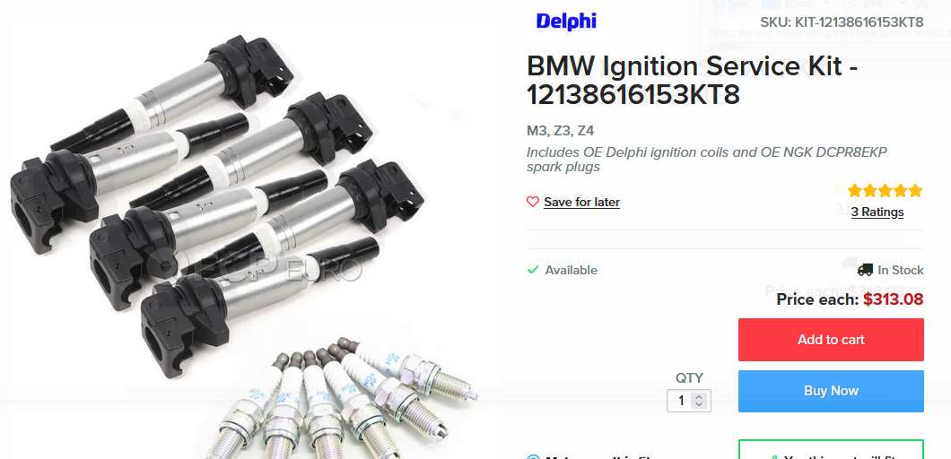

                      Is it worth the extra cost going with the Dinan coils or should I just replace with Bosch?
                        I'd go with whatever is OE
                          I replaced all coils to eldor when one coil went out back in 2022, I haven't had any issues so far almost about 29k miles ago.
                          but these seem higher priced now than they were back in 2022
                          weird thing it doesn't list E46 M3 on FCP fitment list, i think it used to.
                            How does the Delphi stack up against the Eldor? I'm currently looking at this Delphi set that includes the NGK plugs. Definitely not cheap though.
