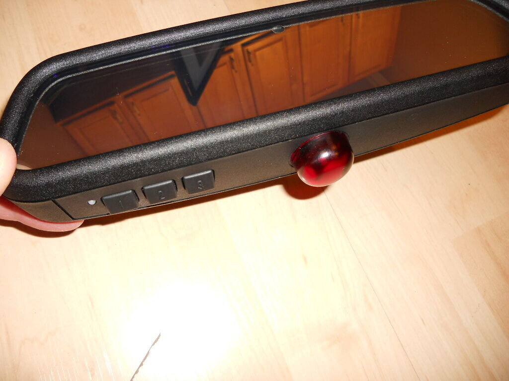

          When I installed the HomeLink enabled mirror replacement, I didn't wire anything. Just mounted and plugged the new mirror in, basically this...

            Sure enough, it was tucked WAY back on the right side.

              Same, I bought a flat nose one from eBay that has homelink, hidden compass and auto dimming for $60. Plug and play unless you have the SOS mirror. You have to cut wires 4-7 so you don't fry the auto dimming feature.
