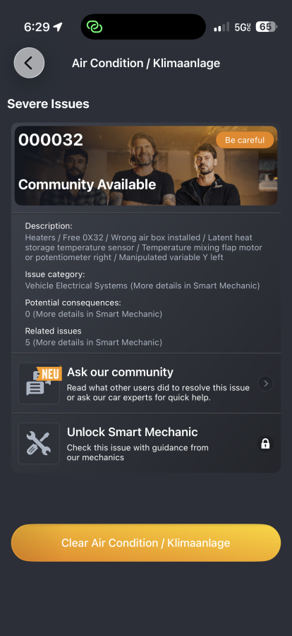

        With the manual climate controller installed. This is what shows up on the scan. I wonder if this affects anything else in the car?

          You can't switch to the manual control without changing out the heater core box. They are specific. Manual control has its own separate box.
          George Hill confirmed this with a YouTube video
            #35
            https://youtu.be/5ubvA1DAOAo?is=KYG2hSJFoR9ctSJB
            I was wondering if anyone successfully done the conversion?
