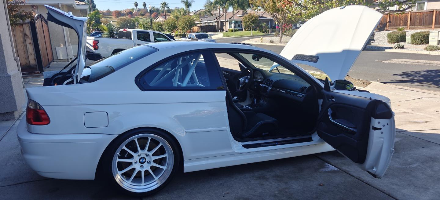

    I have two of the ones Bimmerworld sells. (Kirk Racing)
    They are awkward to install and the fitment on the rear wheel well isn’t perfect, but with a proper sequencing tightening it down, it ends up OK.
    Depending on how that goes, you might need drill another hole on the brace/leg joint. Take your time and it will come out better.
      Contact Ben, he will take care of you.
      Mine is everything you could ask for, plus Ben went out of his way to make mine a custom one-off. Fitment is spot-on.
