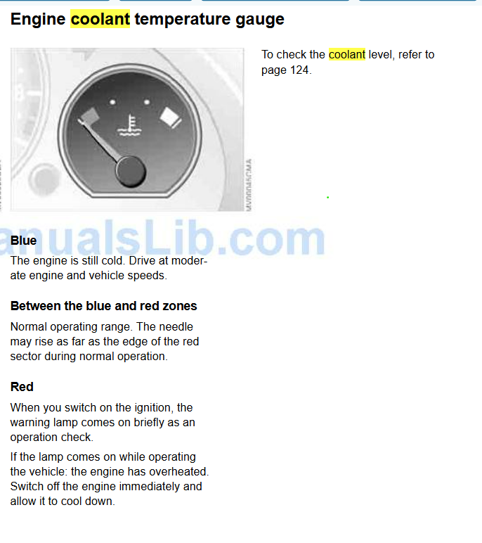

                      Knowing the right dot is considered "normal", is that a new thing? IDK, my car is a street driven car I've had for 16 yrs and it didn't used to go past center, except on occasion, just ever so slightly, on the hottest Florida days, but now, I'm having it go up to the right dot and a little more, in stop and go traffic on hot days more often than I can count on all my fingers and toes. I think that I either have some air in the system from when some cooling system parts were replaced and the system wasn't properly bled or some other component is failing and I just haven't found out which one yet. I've had the following components replaced over the past 5-6 yrs: fan clutch, fan blade, thermostat, water temp sensor, coolant expansion tank, water pipe O-ring, aux fan switch, lower radiator hose and coolant(a gallon at a time, when the lower radiator hose, coolant expansion tank, and coolant temp sensor were replaced).
                      The manual says it's "normal" though I've only had it on hot track days. Normal driving I'm closer to the left dot and idling the center. I'm in the Chicago area so it's not oppressively hot here constantly.
                        Click image for larger version  Name:	image.png Views:	50 Size:	128.5 KB ID:	356101​
                        Glad this got attached. It's always been interesting to me that BMW says reaching the edge of the red is normal.
