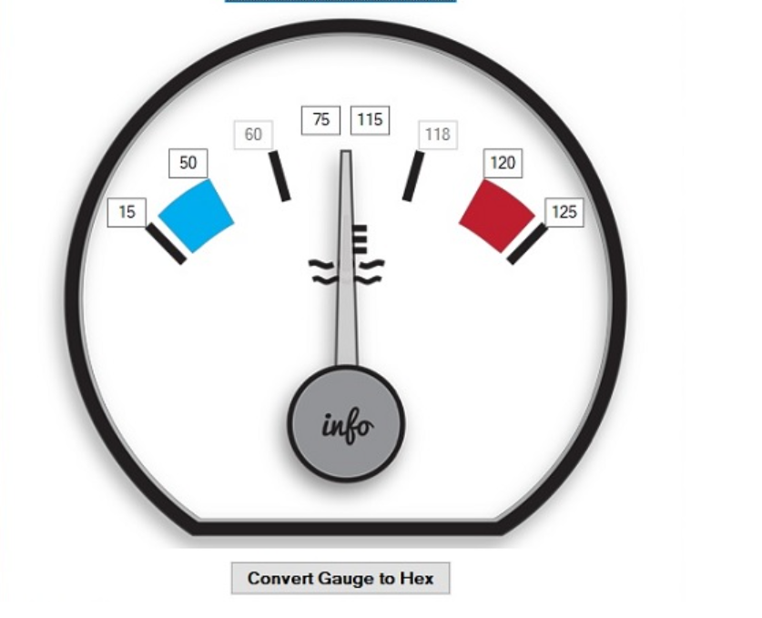

            I think the stock gauge for M3 is similar to this con-M gauge with real degrees overlay as below, although we should ignore the buffered zone at the middle [75 to 115] for the M3.
            So the start of the red zone is about 120C, but your reader shows 104C. This is why I think your gauge is not stock.

                    Well this is interesting... Based on the values you provided my gauge is operating perfectly. If thats the case, how are people claiming to run over those values and still be in the middle? Im not convinced people are doing Texas and SoCal track days with their coolant temp never passing 105C which seems to be still within acceptable operating temp? Ive seen dozens of posts with people stating they "never pass center" Yet past center doesn't seem at all like an extreme coolant temp according to the data you provided. Per my data, I start falling just to the right of center at exactly 95C.

                        Thanks. I didn't dig in much. So OP gauge at start of red zone at 104C is correct for a stock gauge, and the end of red zone is 115C, seems to be low for a cracked head??? Compared to the non-M that the start red is 120C which is too late for the driver to save his head.
                        Code:Non-M Default M3 Default Recommended non-M Function / Angle
                        0x0F (15ºC) 0x0F (15ºC) 0x0F (15ºC) Gauge Start (0º)
                        0x32 (50ºC) 0x3C (60ºC) 0x41 (65ºC) End of Blue (15.5º)
                        0x4B (75ºC) 0x55 (85ºC) 0x5A (90ºC) Center (Buffer Start) (45º)
                        0x73 (115ºC) 0x5F (95ºC) 0x64 (100ºC) Center (Buffer End) (45º)
                        0x7D (125ºC) 0x69 (105ºC) 0x6E (110ºC) Start of Red (79º)
                        0x8F (143ºC) 0x73 (115ºC) 0x73 (115ºC) End of Red or LED on?? (84º)​
