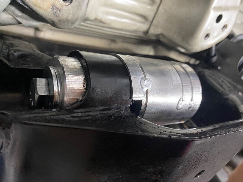

          This photo in particular - from the redeye tool reviews - gives me some hope.
          Click image for larger version  Name:	1773159934__1773159921790-img_5371__original.jpeg?auto=format&w=1024.jpg Views:	0 Size:	70.0 KB ID:	352478
          Hard to tell for sure but it kinda looks like it was taken as he was backing the bolt back out after and the bushing is not intact, so likely in the same condition beforehand as mine is.
          with the inner cylinder being fully solid like this one it just might be that my concern here is invalid. Can anyone confirm?

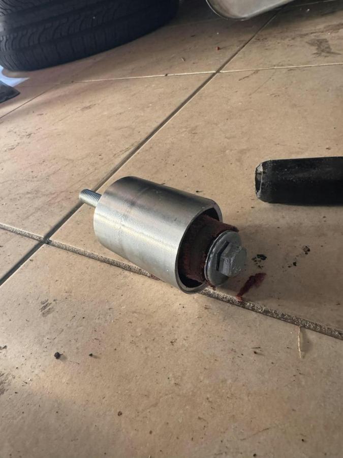

          Click image for larger version  Name:	IMG_9583R.jpg?v=1729057155.jpg Views:	0 Size:	98.7 KB ID:	352479
          My confidence is growing. Now... since that front bolt is basically floating in place there, I'm curious what steps I might need to take, if any, to make sure everything is nicely anchored and not at risk for when I try to get that 21mm bolt started on its way out.

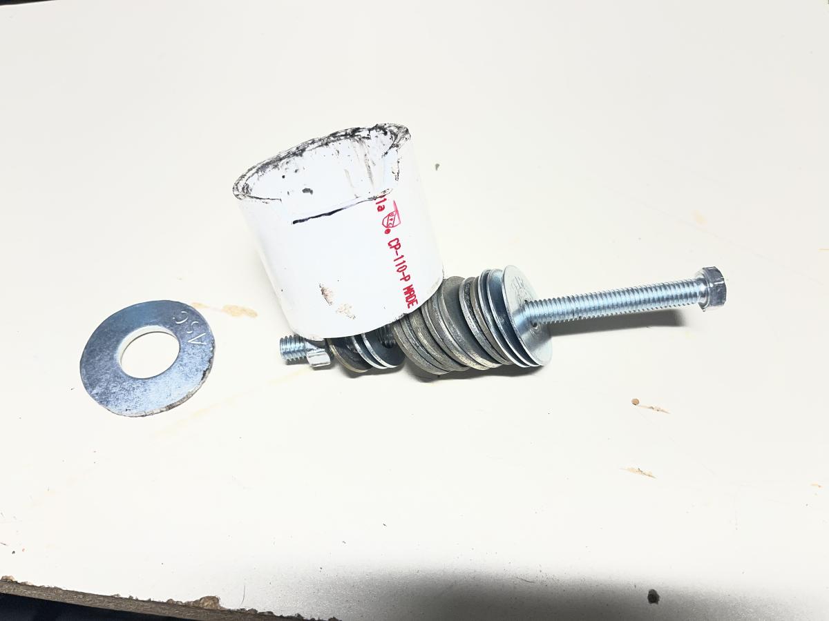

                  I made a tool with a large bolt, some washers i ground to fit and a piece of pvc, 2.5 in i. Took maybe 2 mins to make the cuts to use the tool and it worked like a charm.
                  the job sucks because unless you oull the subframe its a tight fit, but its totally do-able in car with some parts removed
                  Theres no reason to buy a fancy tool, this is about $10 in parts from lowes and a bit of your time. I will add pics of what i used

                    Oh I have no doubt that you can custom make a tool. I did the same using RTAB and Koch pieces in the past (without any guidance, even... I used to be kinda good at this stuff once upon a time). I'm just not experienced with the edge of the bushing being stuck behind and that is exactly the kind of hurdle that has led me in the past to some very long delays and/or high costs.
