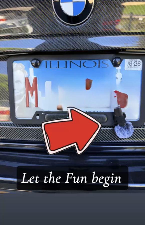

    Hi Everyone, I am aware that my previous sound clip wasn’t the best. here is an updated better exhaust clip for anyone who wondering how the bomiz sounds like. I have attached a mic to my rear license plate. Enjoy!
    NOTE!! I don’t work for Bomiz nor do I associate myself with them or advertise for them. Just helping the community out.

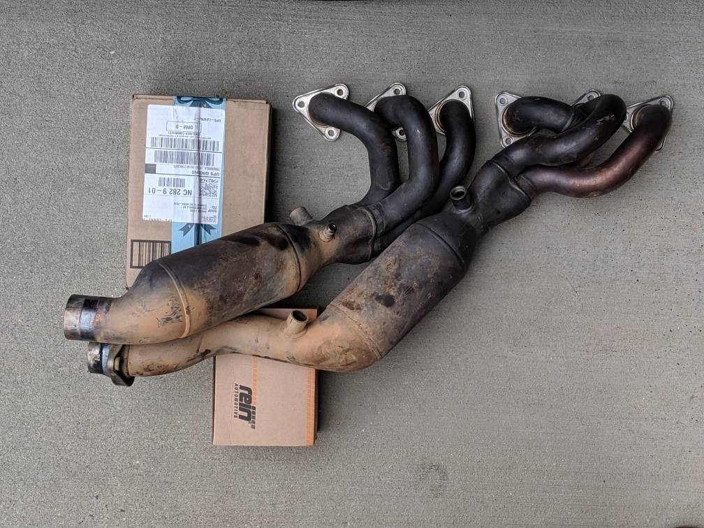

                        Post-collector flange locations are swapped on USDM and euro headers (most aftermarket headers are like the euros). USDMs have the flange for the longer bank on the left and euros have it on the right.
                        USDM:

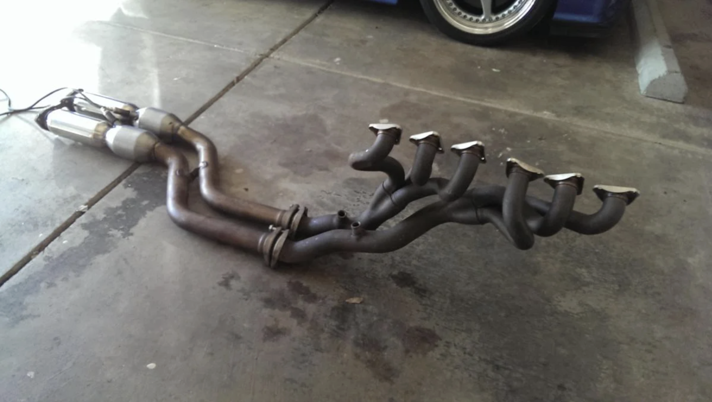

                        Euro:

                        All the "equal length" section 1s I've seen have the squiggly (i.e. longer) pipe on the left, which means they're designed to be used with euro headers. They won't even out the length of the USDM headers, they'll actually make the discrepancy larger.
