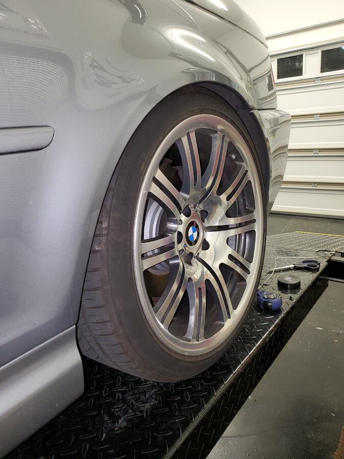

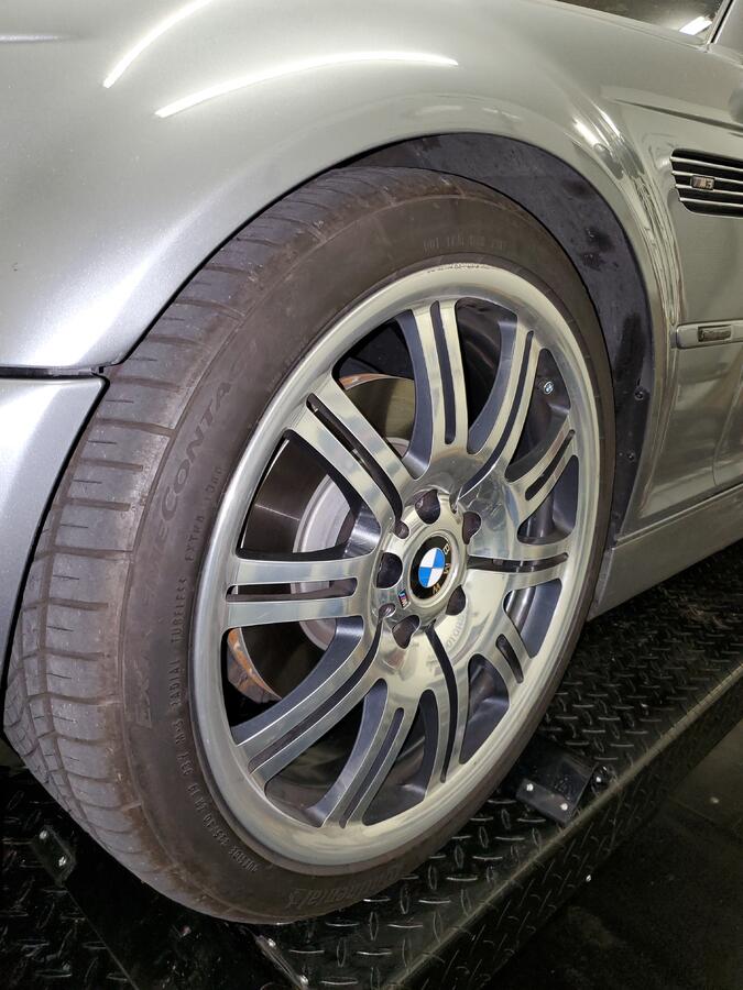

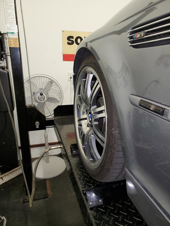

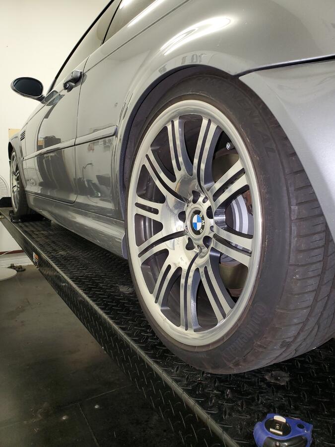

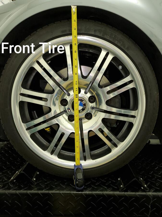

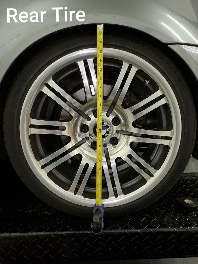

    I am looking to replace my style 67's with a lighter 18" wheel and have narrowed it down to Arc-8's or Sportlines.
    Let me preface this with the fact that I know very little about wheel fitment and am quite honestly just learning about things like offset etc.
    To add to my confusion the previous owner installed a set of BC coils and the ride height is obviously lowered more than a stock vehicle as well as the rear wheels having some negative camber. I do have all stock suspension components as well though.

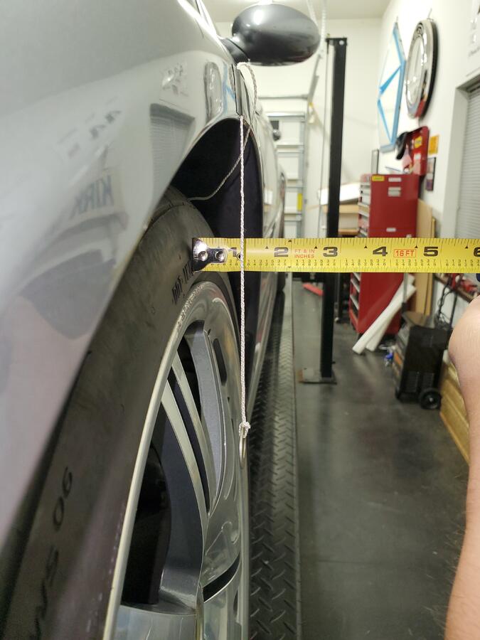

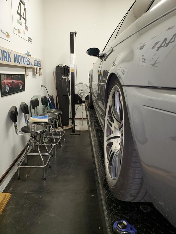

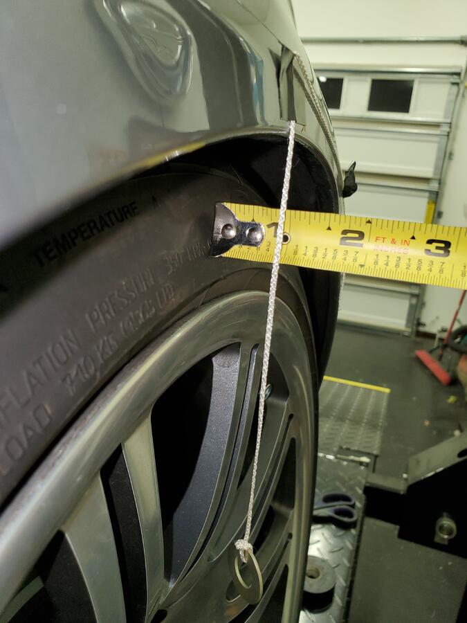

    I measured from the side wall to a string and the gap in the front is approximately 1" and the gap at the rear is approximately 7/8".
    Fender to center on the front is approximately 13.5" and fender to center or the rear is approximately 12.5".
    I am thinking about a staggered setup 8.5/9.5 and would like to run 235/265 as opposed to the 225/255 that are currently installed.
    As far as the spacers go I would like flush or near flush fitment but not so crazy as the fling dirt down the side of the vehicle.
    The rear worries me as it is just so low and it sure looks that by the time I had flush wheel fitment the tires would almost certainly rub and I am NOT wanting to roll the fenders at this point. It may be as simple as running the ride height up on the coils and/or adding a bit of neg. camber, however the camber LOOKS somewhat aggressive as is. I may just have to get the wheels then rent a spacer kit to get those dialed in.
    My questions are in regards to with the given information and pictures what offsets/spacers would you think I would want to run?
    Thank you for any help, I am just starting the learning process. Click image for larger version

    There are a few good videos on offset. This site will help determine the fitment of old wheels vs new - https://www.willtheyfit.com/
    For height, measure from the bottom of the rim to the top of the fender and subtract the radius of the rim.
      Take a look at this too if you haven't already. I've found it helpful even if I'm buying wheels other than Apex ones
      https://support.apexraceparts.com/hc...-Fitment-Guide
        Yeah honestly I would just email with Apex, Bimmerworld, or Titan7. Tell them what you're goals are and I am sure they will tell you what you need. If you can get the right offset to get the fit you want without running spacers than do that. Nothing inherently wrong with spacers but why use em if you dont need em?
        Apex has the best selection of sizes though. I have the arc-8, TA-16 and the TS-7s. They are all great wheels and you wont be disappointed with any of them.

            Offset is easy to calculate. It's quite simply how far in our out the wheel mounting face is relative to the centreline of wheel itself. Further towards the outside of the rim is positive, while the other way is negative. Basically, the lower the offset, the further outwards your wheels will sit. This must be taken into consideration when choosing tyre width/profile.
            Regarding alloy's themselves, have you considered going down the 4 x rear 18" style 67's (18 x 9" +26)? Been done plenty of times and you can figure out how it will sit with little work. A 255 square setup maybe? Idk how it would affect daily driving i.e. more tramlining etc.?

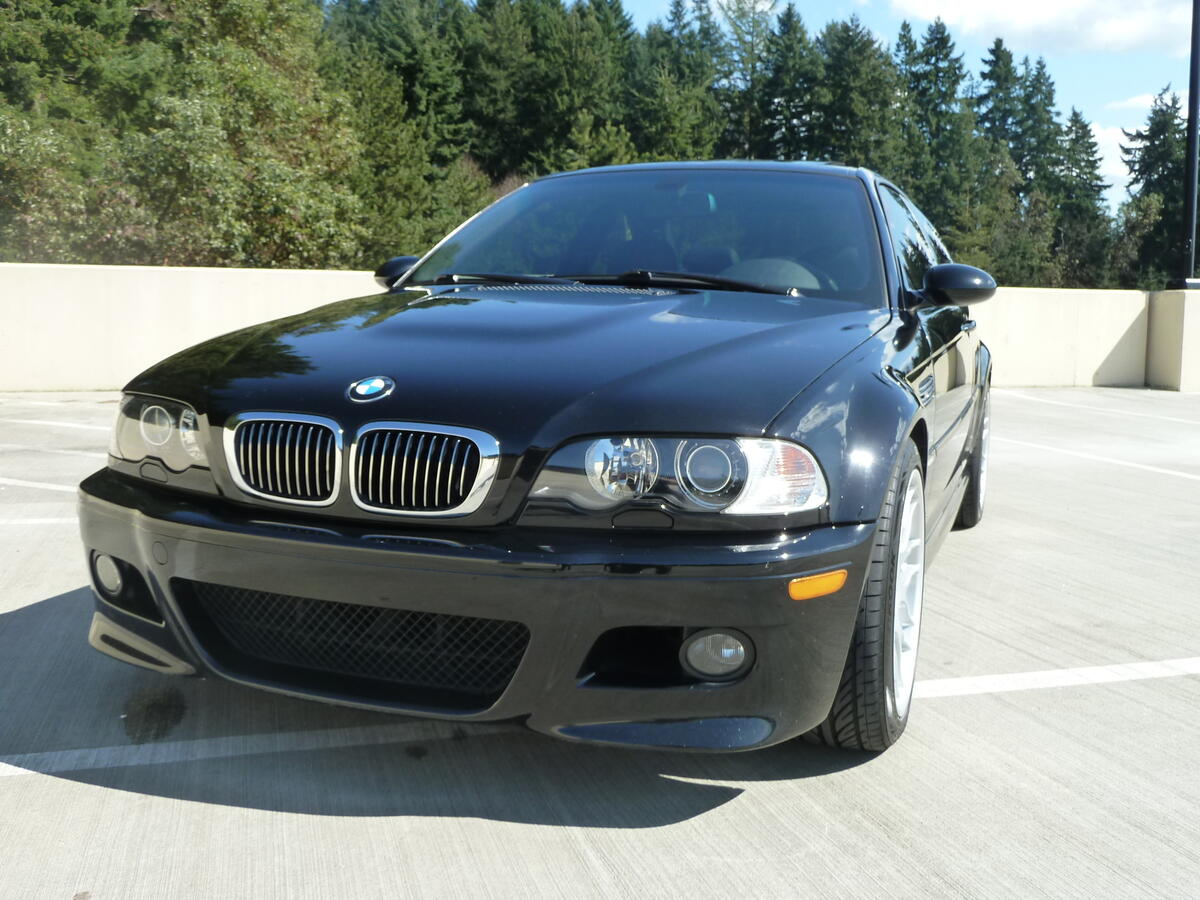

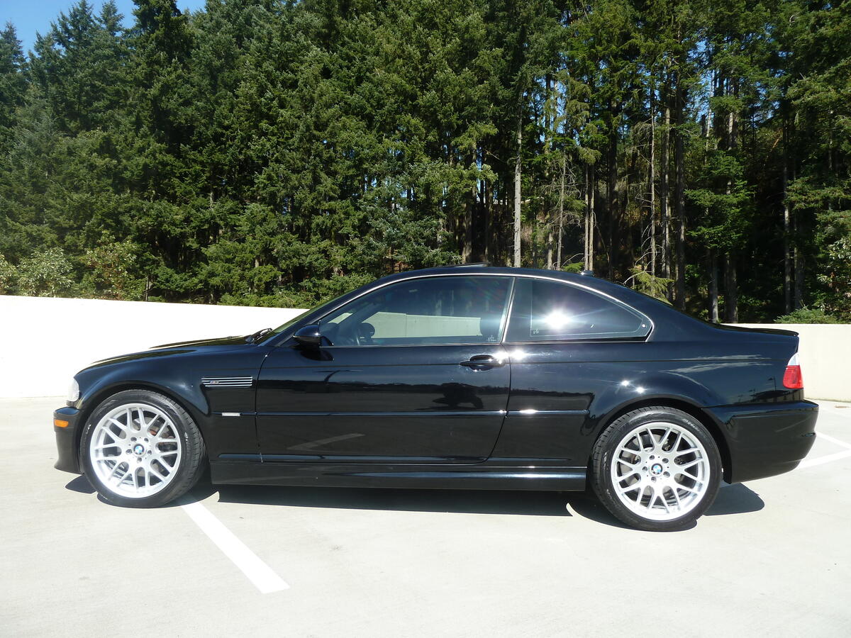

                  Not sure if this helps, but here are my CS.16 Sportlines. I believe they had to change the design slightly since BMW sued them, but I could be wrong. Tires are 245/40-18 & Front wheel is 18*8.5 ET35. Rear is 275/35-18 & wheel is 18*9.5 ET22.

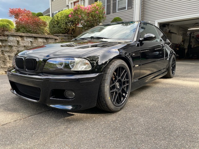

                        I went with square setup, Apex EC-7, 18 x 9.5 et 35 with MPSS 265/35/18. I know you didn’t list these as an option, but adding to help inform. I didn’t have any clearance options until I installed KW V2, with the progressive spring in the front I had to add a spacer to fit. Apex assumed a 5mm would work, but I ended up with 12mm all around, probably could have used something less. I only ran into rubbing at the track and was just the fender liner.

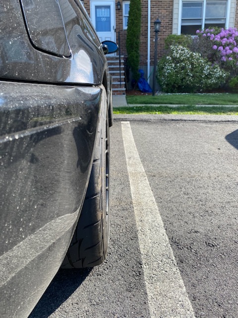

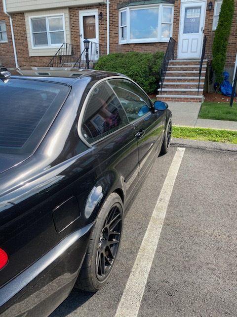

                            I recently had my set up fine tuned. Apex Arc-8's, Front wheels: 18x8.5" ET38, Rear: 18x9.5" ET22. I ended up using 12mm spacers all around along with the Apex 75mm M12 stud kit. I also have ST coilovers which provide excellent adjustment. I went Firestone Indy 500 on the tires, Front: 235/40R18 and Rear: 265/35R18.
