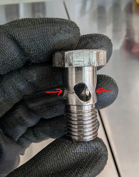

        I quit buying from Race German when I used their SS VANOS line that came with these cheap banjo bolts - could never get it tightened right, turns out it was inferior metal and yielded and necked!

          this looks horrible!
          Will note to not buy from them. Thanks
            Yeah, I replaced it with an OEM bolt from the dealer and wouldn't you know it, it worked perfectly.

              you sure you want to be running that vanos line? Updated factory line, with the additional mount point, has proven to be pretty faultless...
