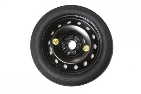

          I own the factory temp spare setup with the steel rim and Conti 125/80/17 tire. On paper the tire diameter is 24.9" and my 19" factory size Pilot tire is 26.1". So, I would agree with elbert that it would be a good idea to use it only as a front wheel if at all possible provided it clears your brakes. I have the stock US spec front brake setup and last I looked into this, it would clear (I guess I should test fit it after all these years!). I can't say it clears a factory ZCP kit however, but I'm almost certain it would not clear a BBK setup on either axle. The spare you link to may be a different offset so you'll have to dig into the dimensions for sure.
            Here's my full story. I found a donut that fits both my E46 Comp and my E39 M5. Never used on M3, has saved me twice on M5: https://chrisparente.com/2011/09/05/...for-my-e39-m5/

              Looked at Bimmerzone spares, they dont have a specific one for E46 however there is e90, wonder if that would be compatible.
              SALE!! AFTERMARKET JACK KIT PRICE DROP!! WAS $79 now $59!! Application: BMW 2008-2013 E90, E92, E93 M3 (Includes Performance Package ZCP) - Not for the regular 3 Series About The E90+ M3  Spare Tire: The BMW E90+ M3 Spare Tire consists of the following: Wheel (Genuine BMW) & Tire (Yokohama T145/70-18). This spare c
              The modernspare version is 18 inches so it should clear the front brakes, on their specs this wheel covers both e46 and e90 as year range is from 2000-2013.

                  In post #3 on another thread is what I use, not sure if still available.

                  P/N: 36116750007

                    ECS tuning does sell this with a tire for 240, will most likely be ordering from them
                    sizes for the rear tires are actually very close, i currently have 275/30/R19, and spare comes with 135/80/R17 are practically the same so it should be ok for short distances i think.

                      anyone know if the 36116750007 clears ZCP e46 m3 brakes?
