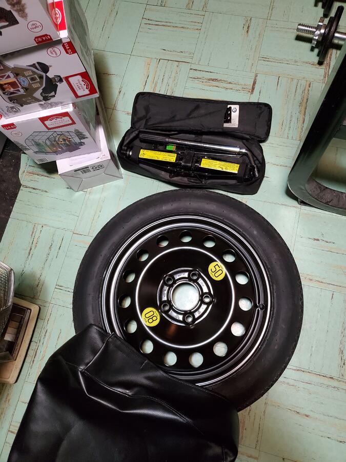

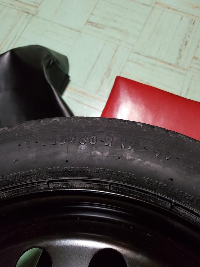

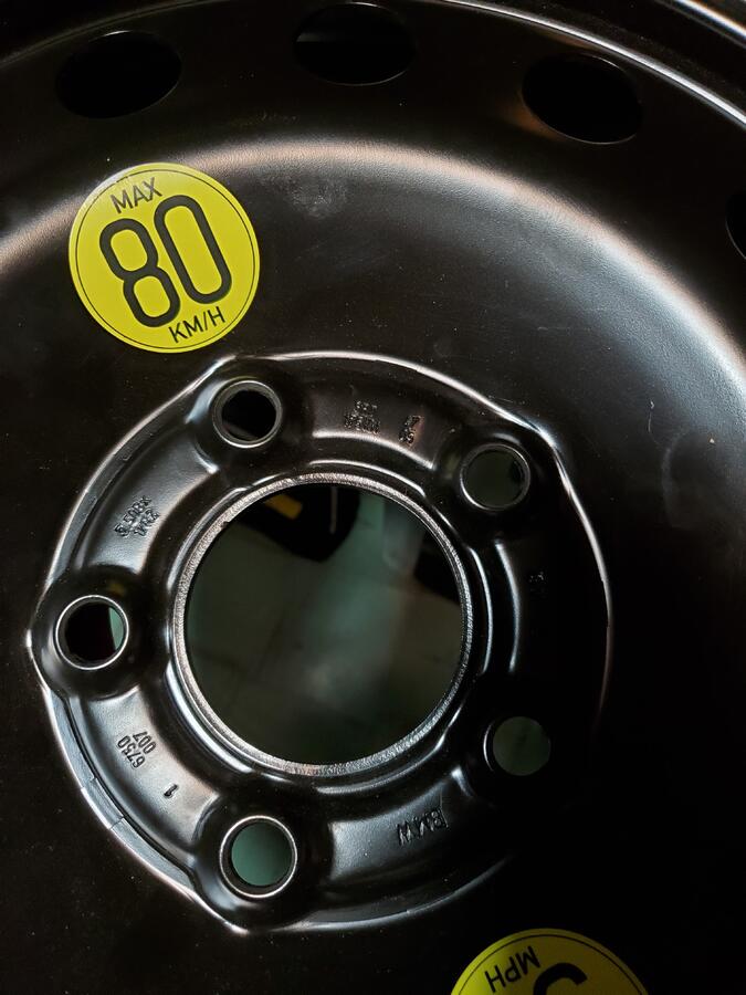

      This stuff came with my car and its great to thrown in when I'm going out of town. Took a snapshot of some #'s on the wheel, not so sure they will be of any help.

        Tire size.com listed the 125/80 R17 diameter = 24.9" which is perfect for my ZCP stock wheels which I measured to be close to 25" . Now I just have to find which car came with your spare tire.
        Thank so much.

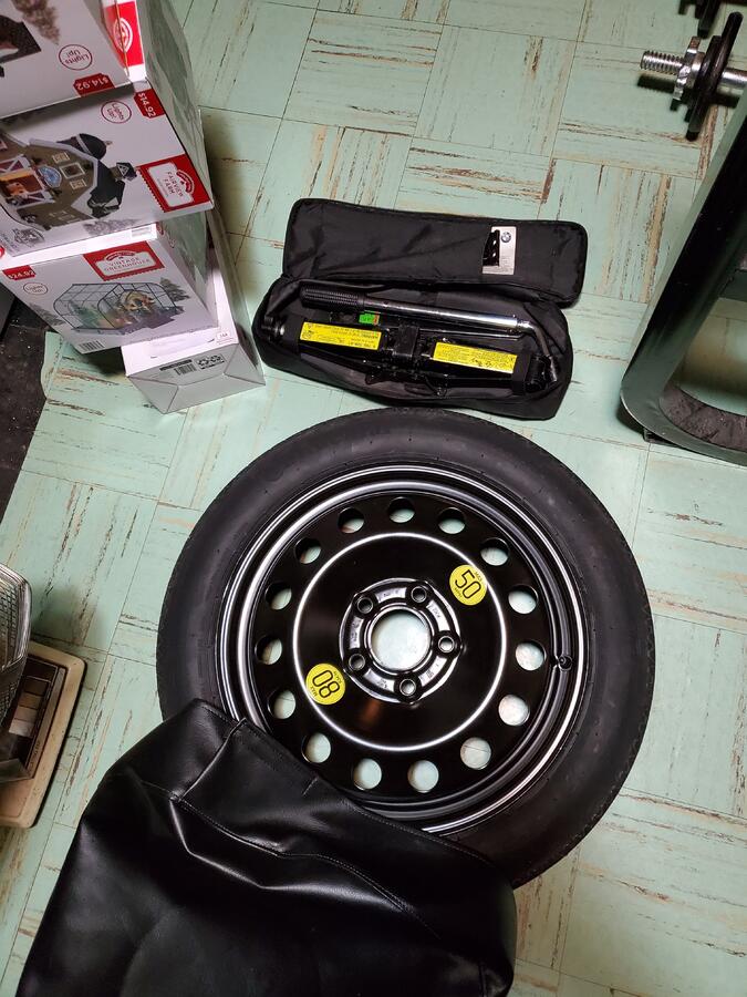

                              This the right wheel?
