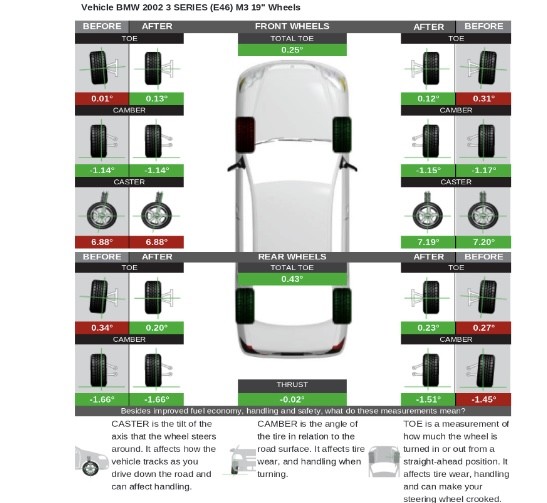

          PS4Ss with plenty of tread. Rears are brand new. I did get an alignment after replacing the RTABS and FCABs with Synchro design works monoball RTABs and Powerflex outer alloy poly FCABs. Here is the alignment sheet. Also no steering angle related codes and checked the live data to confirm that the sensor is reading accurately with the wheel centered. Click image for larger version  Name:	Screenshot 2026-05-14 085404.jpg Views:	0 Size:	67.5 KB ID:	360233

            I think the wheel speed sensors either give a reading or they don't and typically will throw a fault code. I'd inspect the pressure sensors, wiring harness and control unit for signs of brake fluid contamination. Could be a yaw sensor.
            I'd log data which could give you a clue.
