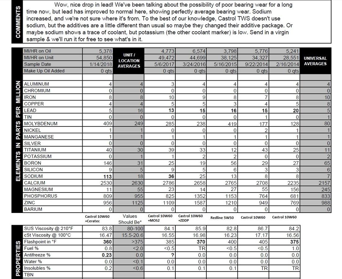

                        OP - Just save up and get your bearings changed out ASAP. MoS2 is just Molybdenum, which is already used in most oil (except Liqui Moly - how ironic!). Ceratec is just Boron and is also already found in most of today's oil.
                        With that said, here's my personal experience with various oil additives - with oil analysis to back it up. Yes...I used my own engine to experiment for you all I have a long-winded post on Zpost if you want to read more about it => https://www.zpost.com/forums/showthr...t=oil+analysis
