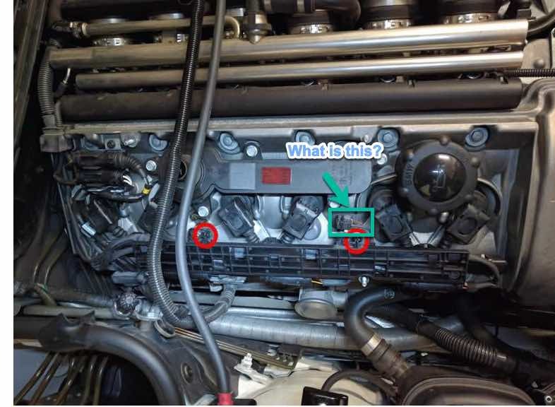

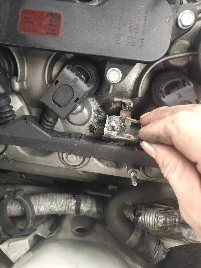

    My car is not idling properly. The following seemed to have melted. Would anyone please tell me what it is and if you have a wiring diagram, I will be most grateful.

    Ground strip?
      Interference suppression capacitor for the ignition coils
        Could high resistance in a coil cause that to melt?
