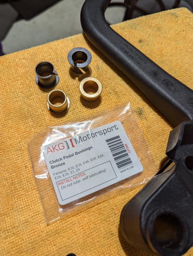

                          Would recommend AKG, they're self lubricating. Those are OEM ones in the picture above, if you're wondering, I didn't cut them.
