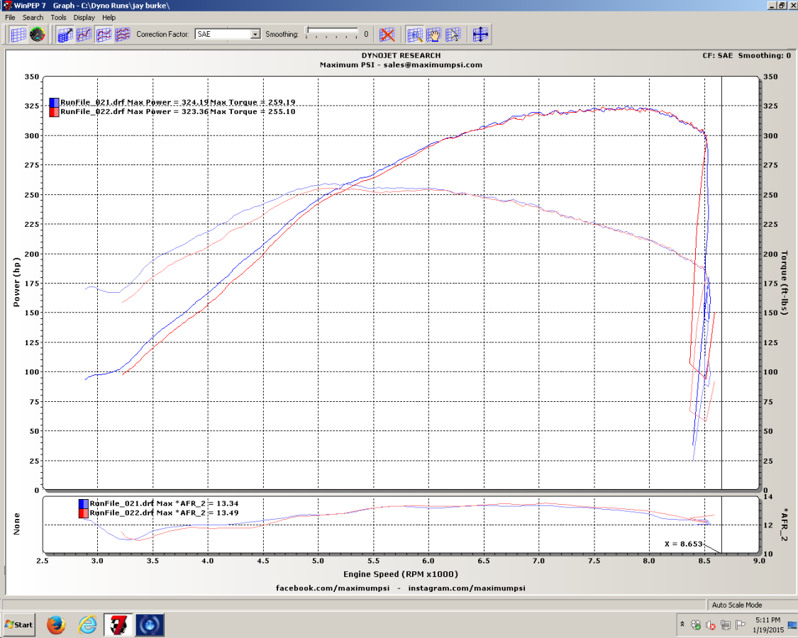

          Click image for larger version  Name:	Jeffy dyno.png Views:	0 Size:	229.2 KB ID:	365950
          ebay headers, no cats, intake, MAP tune... my car is making considerably more hp now. This is the most affordable way to make good power.

            ebay headers, no cats, intake, alpha N... my car is making considerably more hp now. This is the most affordable way to make good power.
                      IMO wouldn’t want that power band for street. What ever exhaust setup you got kill the low end likely the collector length. The S54 should make north of 200 talks at bottom end circa 2500rpm
                        The exhaust on the car at that time was from my m54b30 turbo build, it was a Y pipe with a 3" all the way back, so you are correct.

                            When you said intake, I assume you meant intake. Seems like you actually meant velocity stacks? Intake's on the e46 M3 are generally good for a wash or losing power. Velocity stacks can change things up.
                            Short velocity stacks gut the bottom end to get high end power-- as your dyno shows. Generally, a pretty terrible setup for a car that sees any street use.
                            Given the short velocity stacks, I'm actually pretty surprised you didn't make more power. 325 SAE dynojet is in the range of what you should be able to get with headers/cat delete/tune with the stock intake/section 2/muffler, without gutting the bottom end. What muffler are you running? Lots of the non M e46 mufflers can cork the S54 up (vs, the stock M3 muffler flows very well-- aftermarket is a wash or power loss vs stock, generally).
                              There isn't anything inherently wrong with a Y-pipe
                              Correct, as long as the sizing is appropriate. Such as a BW Y-pipe, this was a pos small Y-pipe going into a 3" straight pipe out the back, no muffler. For the math, a single 3" has the surface area of 7.07, stock dual 2.25" is 7.95. A bottle neck, that I didn't want to address at the time.

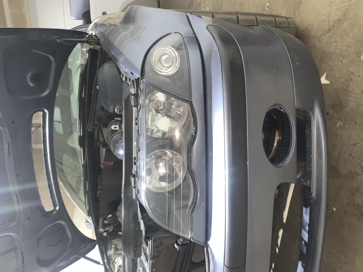

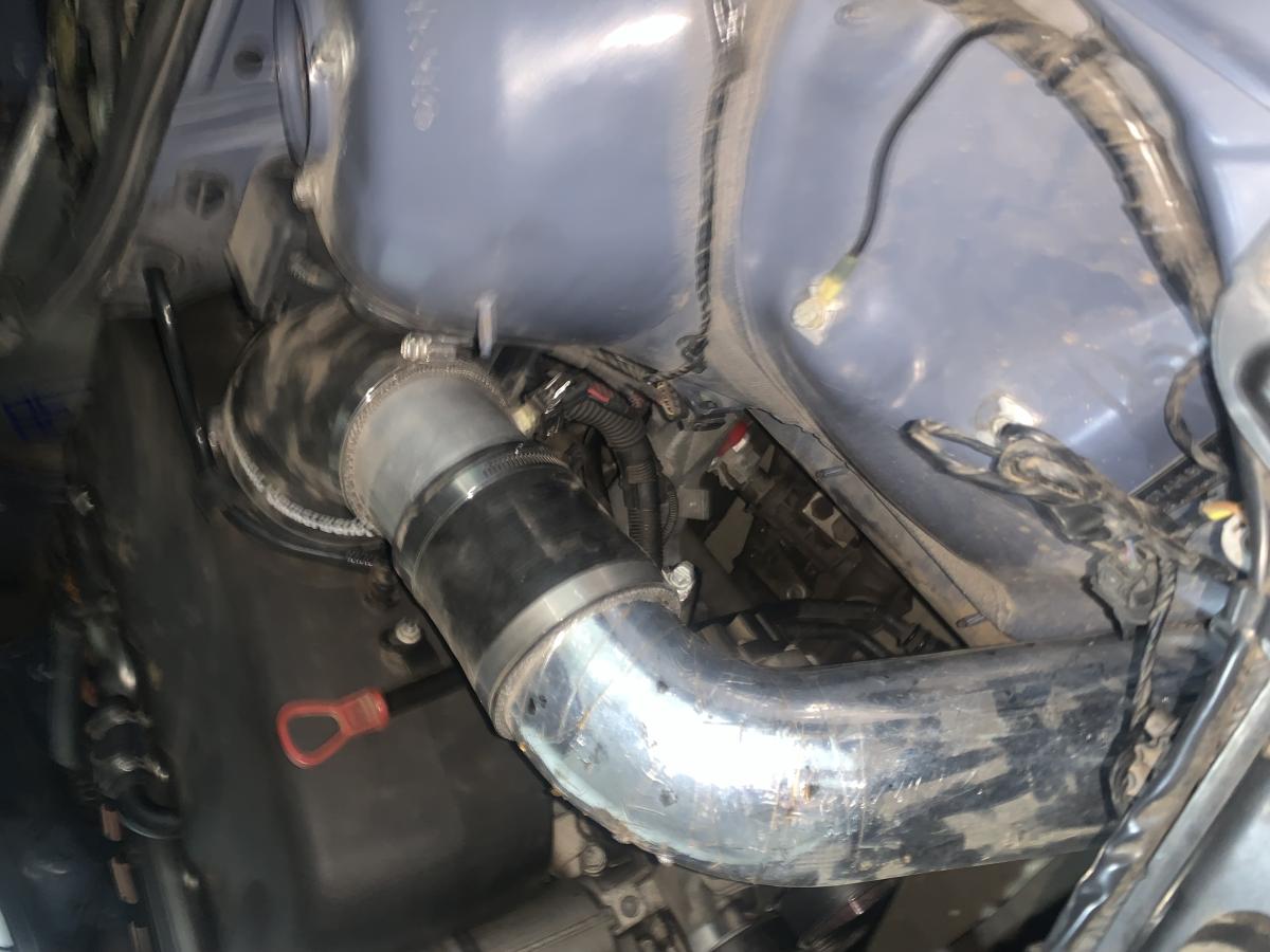

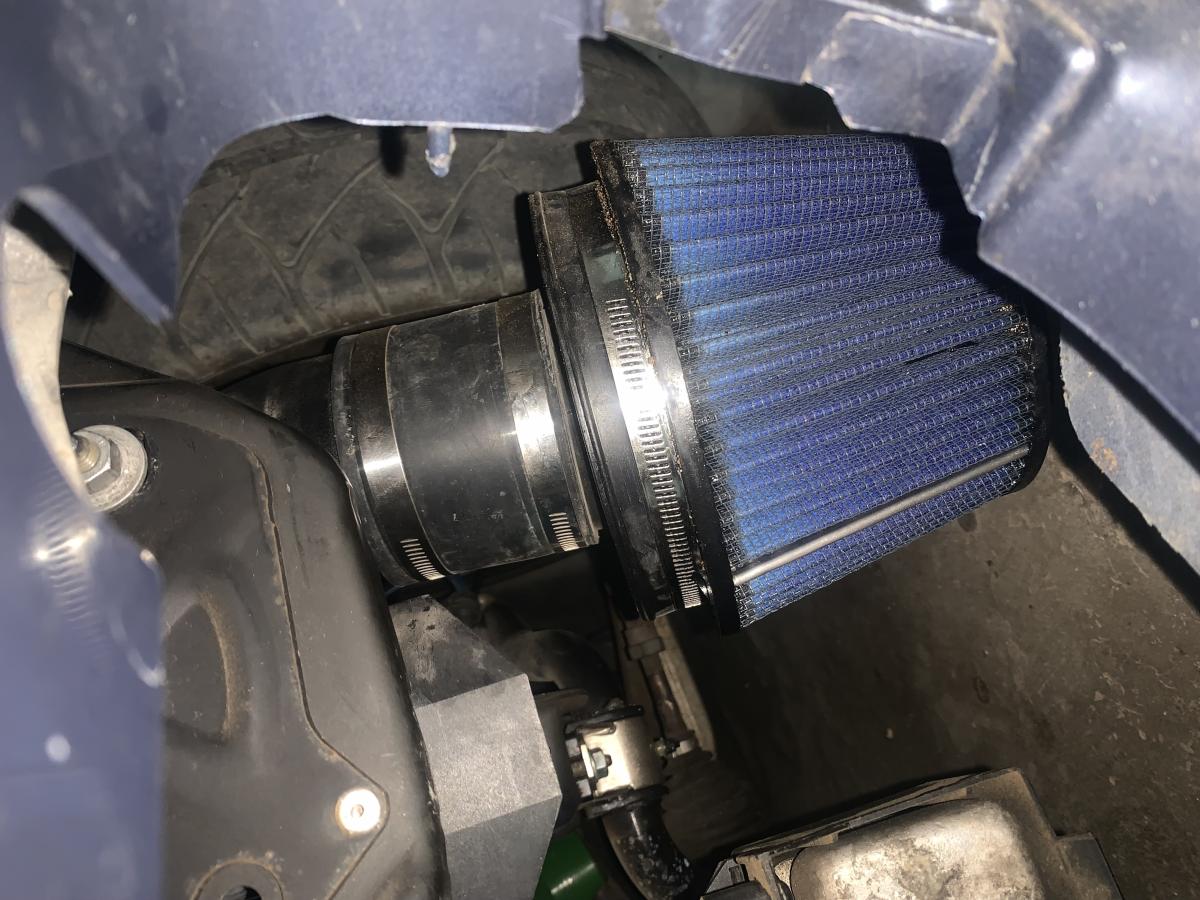

                                We are talking past each other here, the exhaust is as I stated in the above response. The velocity stack, I linked isn't replacing the velocity stacks inside the stock airbox. It is one component of the "intake system". This pictures should get us both on the same page, a bit confusing I understand. These "mods" aren't conventional for this platform. The Map sensor can be seen in the first intake pipe, after the elbow. The velocity stack sits down in the bumper, just before the air filter. Idk why these pictures keep rotating when I upload them?
                                Click image for larger version  Name:	intake MAP.jpg Views:	0 Size:	99.6 KB ID:	366099 Click image for larger version  Name:	intake bumper v stack.jpg Views:	0 Size:	144.4 KB ID:	366100 Click image for larger version  Name:	intake bumper.jpg Views:	0 Size:	115.8 KB ID:	366101
