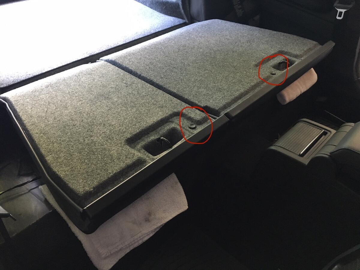

ID:	36565 If the creak you are referring to is the same as mine, its coming from the folding rear seats. There is a rubber/plastic pad that acts as sort of a bump stop. The creak comes from those pieced rubbing together. I added some sil-glyde grease to mine.

        thanks for the input Beefaroni. i think this will be the easiest and least expensive "repair" yet for my e46. I will try it this week.
