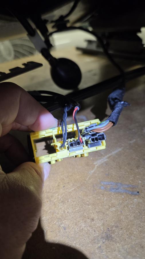

    Edit: here is an under seat photo, I can take a photo of the buckle as well if you need it as I have the D.S buckle assembly off the seat currently.
    The left side connection is just two pins and the other side can be unclipped from the cylinder on the buckle assembly, the middle connection is hard wired to the buckle assembly.

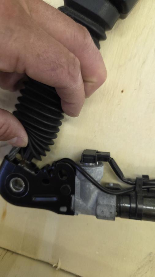

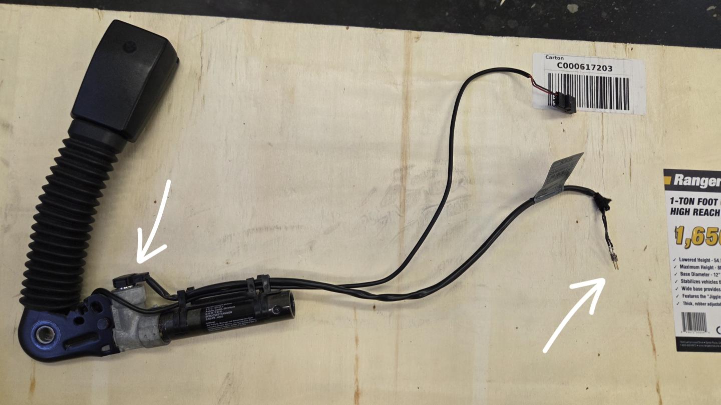

        The wire with the arrows pointing to each end, make sure the connections are good on both sides.
        You'll likely need to remove the seat to check the connection on the buckle side.

          You’re the man. That is exactly it. Thank you.
          Mine is frayed, I am going through a mid-ownership-crisis and getting irritated with my interior. Currently redoing pillars and headliner. I am just worried if I pull the seats, I’ll get carried away and explode my budget .

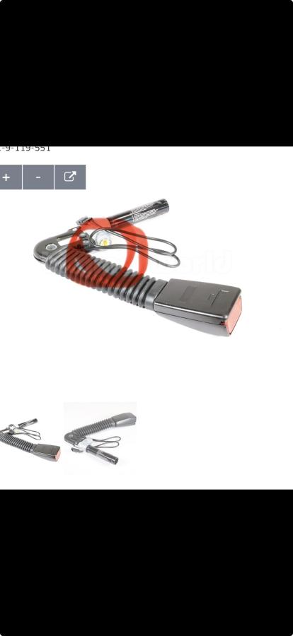

            I enjoy the "find the difficult part number" game. Is this it?
            REAL OEM
            TURNER or TURNER

              I think you’re right it kinda looks a lot like it!
