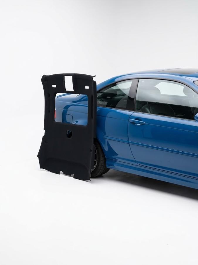

                      Thanks guys. Headliner, visors and C pillars went in yesterday.
                      This was the situation in the beginning of install. My house is a sunroof hate-free zone.
