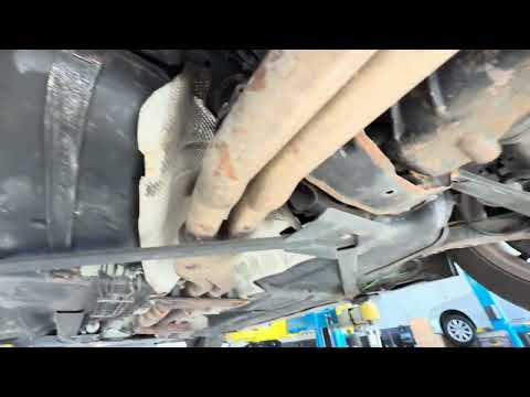

    Looking at buying this E46 M3. Seller says the RACP/subframe mounting area was previously cracked and repaired/reinforced. These are the underside reinforcement and trunk-side photos. For those of you who have professionally repaired E46 RACPs: does this appear structurally and properly repaired? I'm particularly concerned about the weld quality, the trunk-side welding, and the line/crack visible adjacent to the plate. Would you buy this as-is, or have the repair stripped and inspected? Or does this reinforcement appear questionable? He had receipts for the reinforcement however I am questioning the weld quality and was hoping our experts could chime in.
    That is a mediocre underside plate install at best - booger welds and not welding the complete perimeter of the plate. This looks like a DIY or rush job. Wherever they left voids, cracks can propagate out and moisture can get in forming rust, both of which seem to be happening based on those pictures. Best way to assess the job and see if those plates are salvageable is to have a shop remove the rear subframe.
    Inside the trunk looks factory.

      Your awesome, thank you for this reply. Honestly if you were buying an E46 M3, and this is what you found on the list after the seller showed you an invoice for 11k that includes the RACP reinforcement. Would you walk away or try to get the subframe inspected?
        The rear subframe reinforcement requires inpsecting the top side of the front mounts which requires removal of the rear seat bottom and cutting into the sheet metal. Should have a pic of that if the reinforcement was done thoroughly.

          Is that body filler all over/around the plates?
          Also whats up with what appears to be a hole in the reinforcement plate in the first picture?
            Off the shelf spray paint lol. Least they could have done was used the SEM stuff.

              Thats super unfortunate how much time was spent to drop the rear subframe just for someone to learn to weld for the first time.
              As a buyer I would feel more comfortable if a shop did this.
