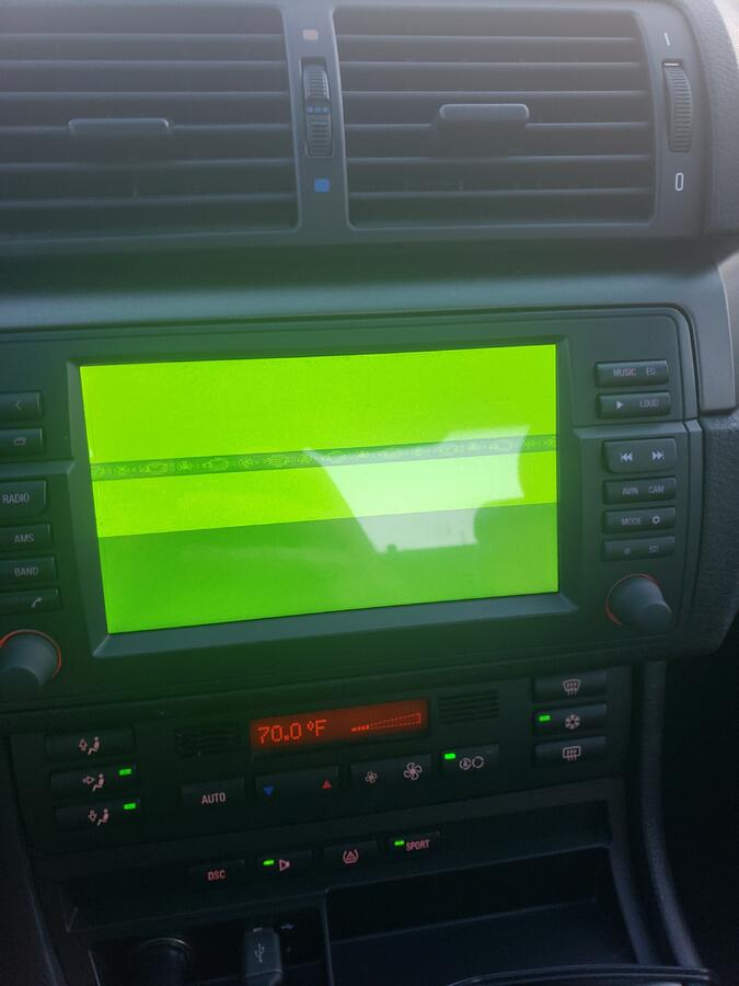

              I purchased the android 10 px6 version a couple of weeks ago. I knew going in that it wouldn't be perfect, but I really like how it looks screen wise (stock looking buttons as well). I didn't have an OEM navigation originally, so it was easier to install myself. I thought about making a thread with pictures of my install and a review that explained some of the menu features I had to dig up from watching youtube videos. The screen is too bright at night so I found someone mention installing a screen dimmer app, and fixed it with that. During the day the glare is real but my windows aren't tinted so YMMV.
              The first day I installed it, it sounded a lot better than the previous owners aftermarket unit. However, coming out of the grocery store the first day the unit didn't turn on with the car. Hasn't happened since, but I've had a couple speakers start buzzing and vibrating. Maybe they were already on the way out, but I've also had delays with android auto when playing music, so I know the unit is sketchy. When I email Avin they take awhile to respond, and respond during a different timezone with sentences that don't really make sense. I like how the unit looks, but I can see it going bad one day and ill probably go with that bluebus adapter on a stock business radio and call it a day. Just my 2cents! p.s. if you run a radar detector that isn't hardwired, the dynavin HVAC relocation bracket cigarette lighter is angled down so it's impossible to use for anything other than a really small usb charger.

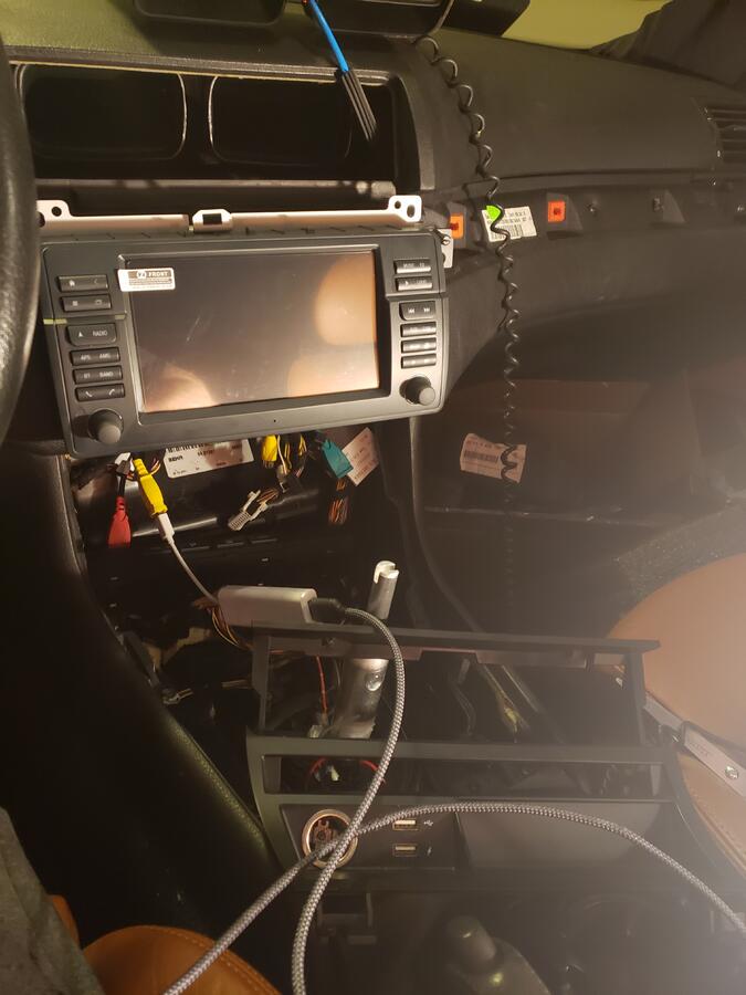

                    I just got mine about 2 months ago. Install for me was fairly easy since I had my interior and trunk completely apart for a refresh already. I have the factory nav setup, so had to run wires.
                    Definitely had a lot of extra wire length and found the best place to tuck it was in front of the rear shock tower behind the trunk carpet (I have a vert so not sure about coupe for this).
