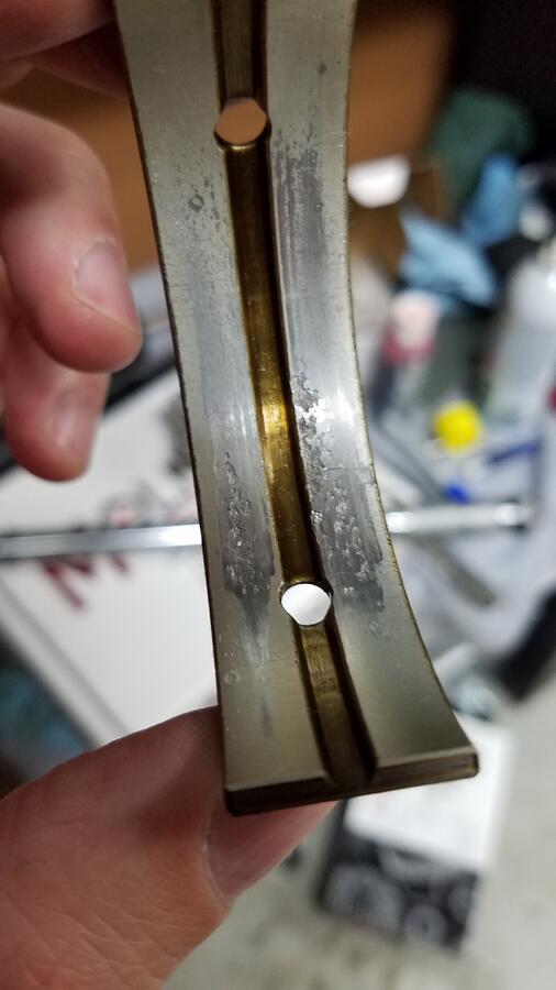

                      I went with king, on lange's recommendation. Ive read the mains are not a wear item but somehow one of the bearings had significant scoring with several edges my fingernail cought. Crank didnt seem too bad. Click image for larger version

                        Lang also recommended king bearings to me. Did you measure clearances?

                          No but im getting the widened rod bearing journal crank, ill ill to check clearances after i get it. He thinks ill be slightly over .002

                            Was the damaged bearing by chance the middle bearing?

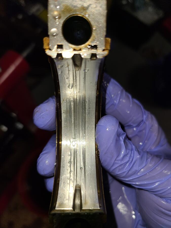

                              I had some wear on one main bearing as well near the center iirc. All of the others looked perfect after 190k miles. replaced the mains with glyco from fcpeuro. The clearance was fine.
