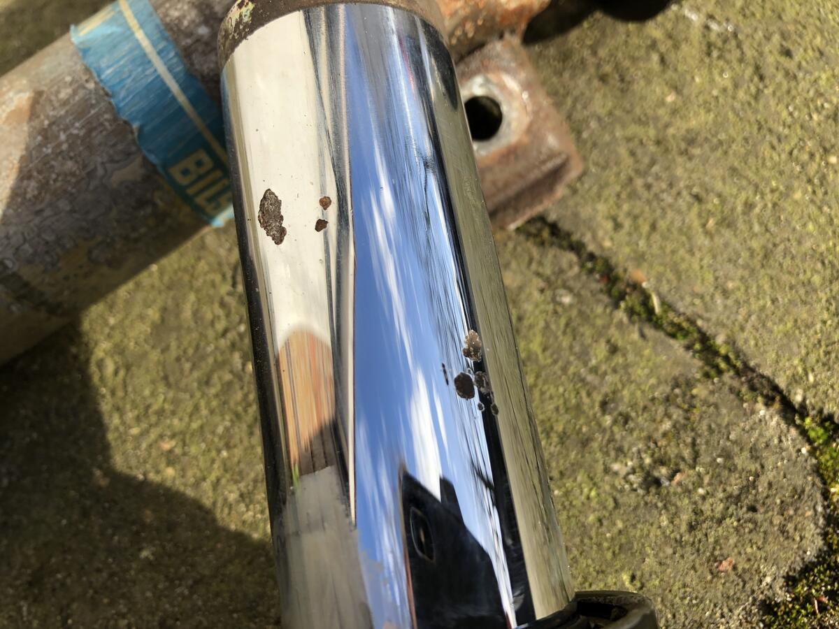

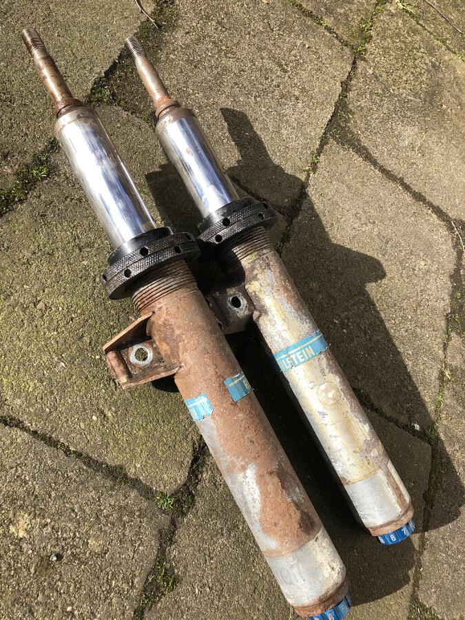

                      Such a variety of opinions on this one & different to my experiences. (...its all about the shocks, not the coils, tried fresh OE Sachs, then hated the Koni, then found the PSS10 totally superb)
                      So its PSS10, but they need corrosion protection at installation, especially greasing up the rear damping adjusters. Photo of mine after 3 winters.
                          The coating is the weak link on these. They don’t even hold up to rain without losing their luster.
                              😱 Wow I cant imagine what your undercarriage must look like. Looks like your suspension was parked in a brine pool. Threads look like they held up ok.
                              My PSS9s look almost new after 7 plus years. But I live at the beach.
                                You sure those aren't parts of the titanic? Wonder why they can just powder coat them or something.
                                Agree though, it's all about the shocks.
