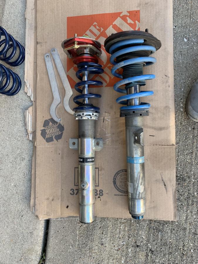

                              Yes, have TMS street plates. This is the only photo I have of them off the car. Not sure what spacer you’re talking about. Re shims, could I add a shim in between the camber plates and upper spring perches?
                              997.1 GT3 Carrara White/Black
                              C43 AMG Diamond Silver/Red​
                                That's about how my car looked with my old PSSs. Yeah, even maxed out it's still a bit low, I had the same problem. You could try using an energy suspension coil spring isolator, you can get them in a bunch of different sizes (thicknesses). You can slap it on the top or bottom of the spring and it will give you more ride height. I use one on my car and they work good.
                                Could I also do the same thing with helper springs? I have a set of Hyperco helper springs sitting in a box. I think the compressed height is around 0.5”, so that should help me get the ride height I’m wanting.
