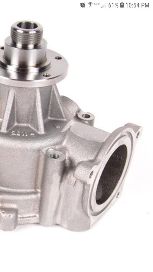

          Saleri does have the bmw logo ground off so probably is the OE part
            Click image for larger version  Name:	Screenshot_20200626-225415_Chrome.jpg Views:	0 Size:	33.5 KB ID:	38181
            The impeller is LASO and metal, so not OE. They most likely are using or reusing the housing similar to what Bosch does with Valeo alternators.

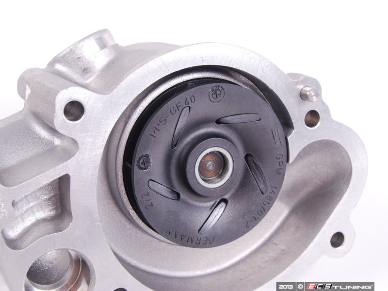

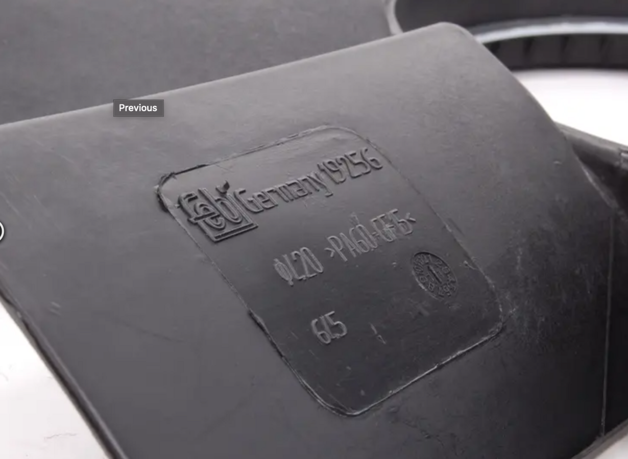

                  ECS has clear photos of the OE pump. My guess is Febi makes the impeller and supplies it to BMW who makes the housing. The part identification looks very similar on Febi's fan blade and the OE BMW water pump impeller -

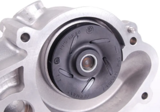

                  "GF-40" 2/2 "GF-15" 6/5
                    Yeah this is a hard one to figure out completely. Saleri makes the non-M E46 water pumps. Saleri is listed at FCPEuro as OE for the M3. And that would be good enough, but on ECSTuning they show Saleri M3 pump using a Laso brand metal impellar. If not for this it would be a done deal. If ECSTuning has wrong photos or Saleri used another impellar for a time, but that's a lot of "if"s.
                    As far as Febi's marking being close to the pumps, actually the SALERI brand E46 non-M impellar resembles markings closer to the M3's pump imho.
                    And if you look at the Genuine BMW pump you can see at the 3 o'clock position a brand marking that looks like a SI. For who? Maybe SalerI? Dunno.

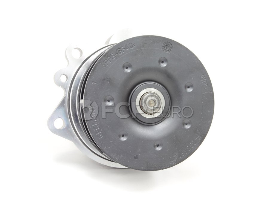

                    M3 Genuine BMW
