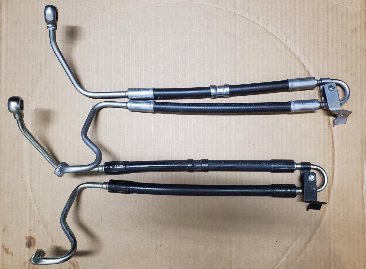

      Well the Rein part and the genuine one are definitely different. Rein is the one with black fittings

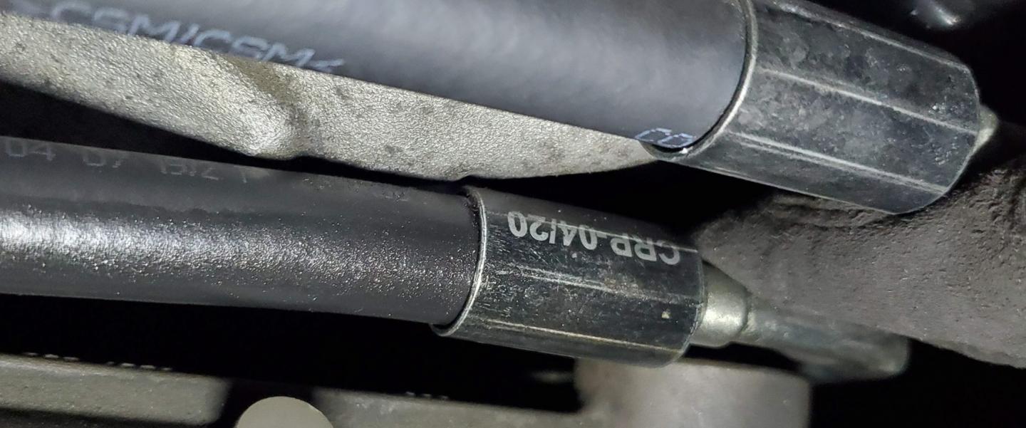

      All the metal parts look different. I measured the Rein fittings at 22 mm OD and the genuine fittings at 19 mm OD. This turns out to make a huge difference when installed. The Rein part was rubbing against my oil pan and slowly wearing a grove into it. Genuine part is miles away from the pan.
      Rein clearance from oil pan (with me pushing down on it slightly):
      Genuine clearance from oil pan (with no pushing):
      Yes, I'm aware you can clock the lines slightly to get them to sit closer/further from the oil pan, but I'm pretty sure I put both of them in roughly the same spot. The issue with the Rein part could have very well been installer error, but the bigger fittings did not help.

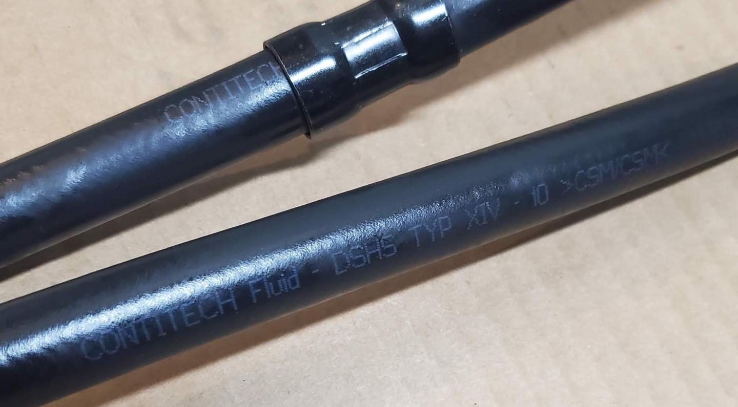

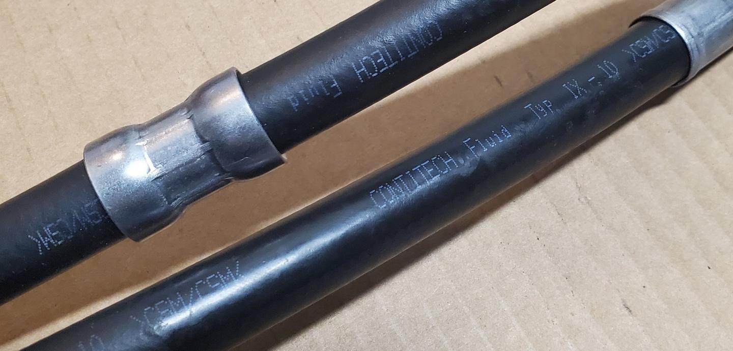

      The hydraulic lines are different too. Both are ContiTech, but the Rein part says TYP XIV-10 and the genuine part says TYP IX-10. Quick search lead me to the Continental page about the IX hose, but I couldn't find much about the XIV hose. Not entirely sure what the difference is here (if any), but regardless, the marking are different.

      So I guess stick with genuine for this part as well.
