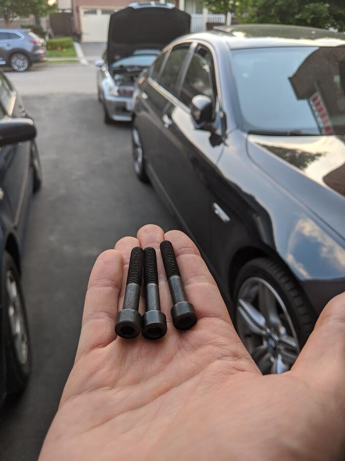

    If i remeber roght, those bolts are welded into that loop underneath. Not aure if that is possible. U less you are trying to scrap it all the way and just do bolts.
      From your pic on post #5 of the underside of the plate, it doesn't look like it's welded, but I could be wrong. You should inspect it and see if it could be a press-in stud, and if so you can just order some from McMaster or local fastener store, then its just a matter of hammering out the old ones and replacing them with new ones that are longer.

        Yep, they are spot welded. I think this is to keep the three bolts in alignment with each other when making camber changes. Going with individual bolts would probably require a lot of fiddling.

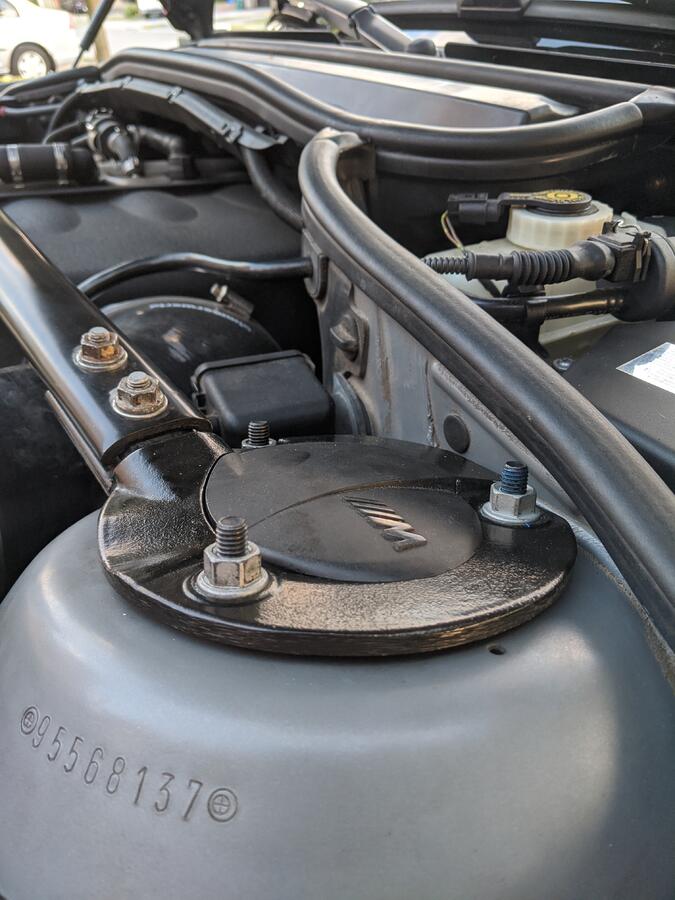

          Update, used new longer bolts. You are correct that tckline bolts/screws are spot welded together. When taking everything apart the caster screws were completely loose and explains some driving characteristics.
          Tightened and cleaned everything up, car now has stopped pulling right. I get much less spring binding noise although it's still persistent at low speed with some coming from the rear perches that are very rusted.

          I retained the reinforcement plate. Tckline rep informed that it's not necessary due to the half moon providing that function, I may take it off when new ec7rs arrive. Apparently you can't reach max camber with it on.
                Whats your definition of max camber??
                i have the plates on and do my own alignment. I have had it as high as 3.8 and usually run around 3.4-3.6.
                lots of fall in on the steering running that high.
