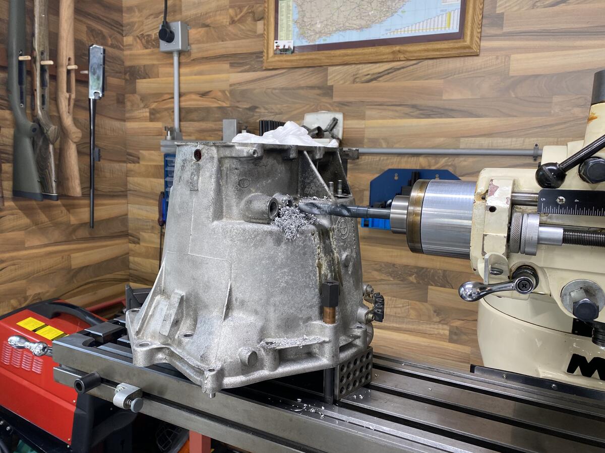

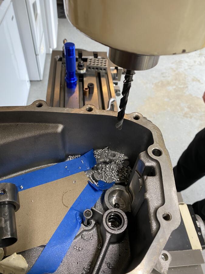

The bell housing machining went as expected. I have access to a good mill and was able to set up the bell housing and machine both detent holes to the specs I found online.
I went the route of threading the holes for an -8AN oring plug fitting, instead of the plugs with the snap-ring. Easier to machine and also service later if needed.

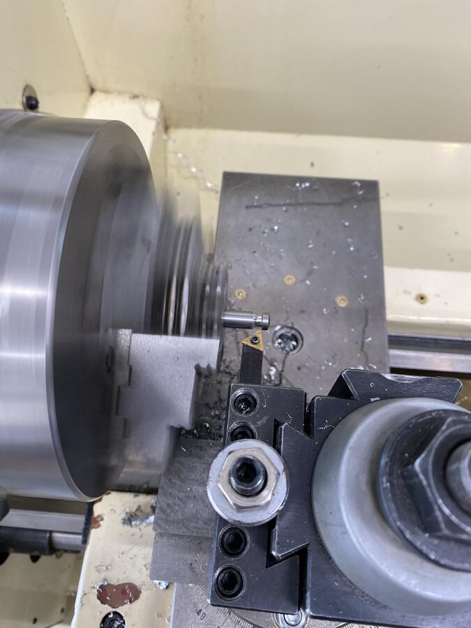

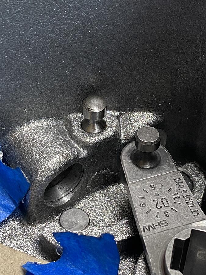

For the spring catch pin on the inside, I used a dowel and machined it to match the pin on the arm inside the bell housing. I bought a pack, and machined a few extra if anyone needs one. Just pay for shipping, and I will send it to you. I have 3.
