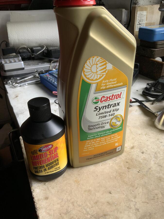

    (Because I’m tight) I’m trying to avoid buying BM OE diff oil (it’s £150 ish for the 3 req bottles here in the UK) and I was hoping my diff would be ok on straight Castrol, but it wasn’t, loads of unwanted aggressive locking on car park turns, roundabouts, etc.
    1-fresh Castrol base oil; not good.
    2-added 25cc of RedLine FM; better, less intervention.
    3-added another 25cc of RedLine; better still, almost gone entirely.
    So I’m on 50cc, just under 5% FM. Don’t want to go too far because I’m told it’ll thin out the oil, could cause diff wear.
    Views & experience on this, how much FM to add?

        See this thread. At 5% you are already at the limit of what anyone recommended.
          Diff fluid is somewhere I dont hold back on. BMW makes their magic formula for this.
            The molybdenumdisulfide FM will not thin out the oil and/or cause accel wear (actually MOS2 is an anti-wear additive in oils), but what it will do, if too much is present, is allow the LSD to slip too much rendering it lifeless 'round turns.
            My opinion is, if not just using the OE lube, is to use as little FM as possible, even putting up with some minor chatter or groaning as that's better than a peg leg.

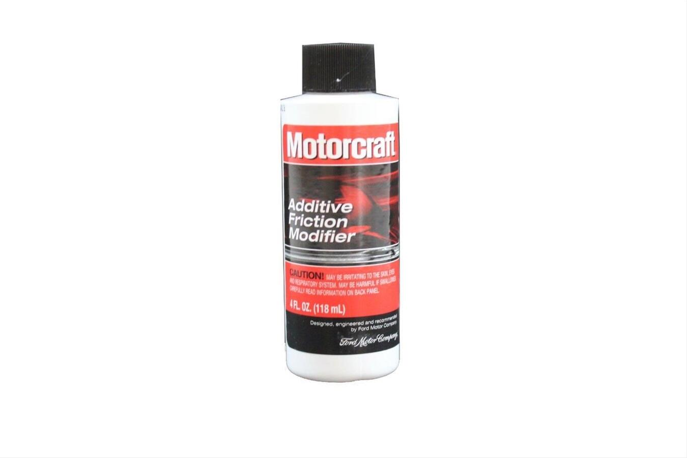

                    About 8 years ago I was researching this "magic BMW potion" fluid and was able to get technical data spec of the actual OE BMW fluid. In deed the original BMW diff fluid contains exactly 4.6% of FM (Friction Modifier) exactly 69ml per 1.5L (1500ml) ususal diff fluid capacity or 23ml per 500ml bottle also friction modifier they use is the same Ford uses in their diffs and can be purchased separately as well Ford Motorcraft XL3 http://rover.ebay.com/rover/1/711-53...QAAOSwDOpb2LN6. I have been using this formula for past 8 years with excellent results as matter of fact just changed my diff fluid last weekend according to this spec 151k on it not a single problem. Works exactly like OE BMW diff fuild, change it every year since I track the car frequently. I wish I saved the spec sheet I had, can't find it anywhere now By the way thread on the old m3forum was my posting. Hope this helps

                      Just in case someone needs this in the future (ebay listings expire eventually), he linked "Ford Motorcraft XL3" friction modifier

                            Good Point 👍 Yes that is exactly it Ford Motorcraft XL3
