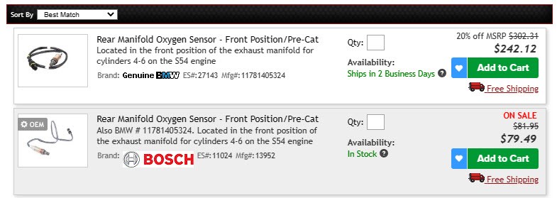

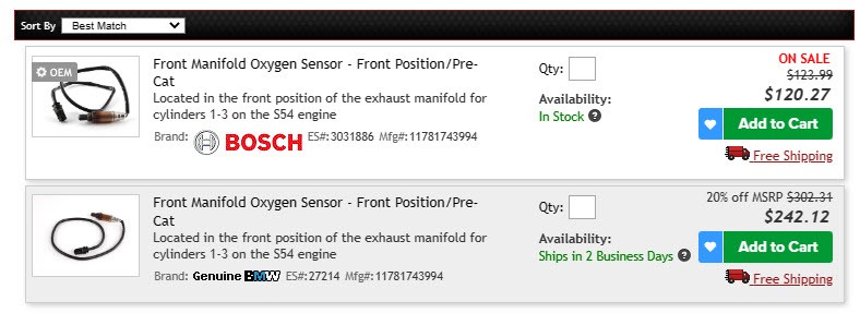

    BOSCH, maker of the OE sensors, their prices, are these legit prices (from ECS Tuning).
    Usual BMW markup's over their BOSCH OE supplier's same parts?
    Urgh.......
    BOSCH part numbers below are just as good, if not same as BMW's own, right? (yes, stupid question)

      You're gonna feel like an even bigger doofus when you find out that the actual sensor (not the harness/plug) is only $20, and you can splice a new one in using the existing cable harness which is the "special part" that allows them to charge $100+ ea.

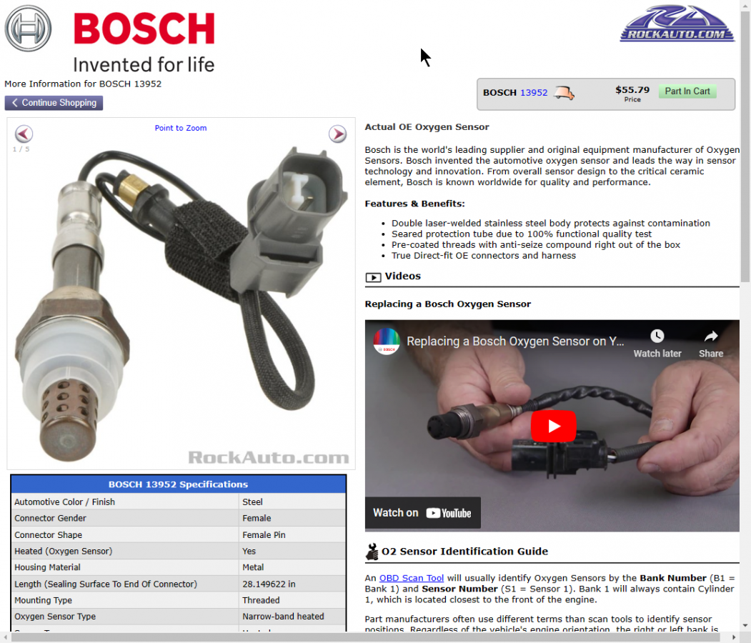

                  Better yet, go to Rockauto. The same Bosch precat sensors are $89 and $56
                        https://www.rockauto.com/en/moreinfo...422302&pt=5132
                        Bank1 oxygen sensor picture on their web site looks "normal".
                        But the picture on their web site for the bank 2 looks odd at the sensor tip? Maybe the picture is not accurate (???).
