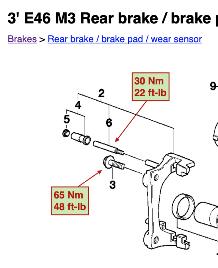

    The correct spec for the rear caliper bracket mount bolt is 48 ft lb. The torque spec guide posted on this forum (and previously on M3F) incorrectly specifies 81 ft lb for both the front and rear.
    I attempted to torque my rear's to 81 ft lb but became concerned and stopped when I could not reach the spec. I dug out the Bentley manual and found that it specified 48 ft lb.

        Is it from the PDF that Flow created? It has 48ft-lbs 65nm for the rear bracket bolts.

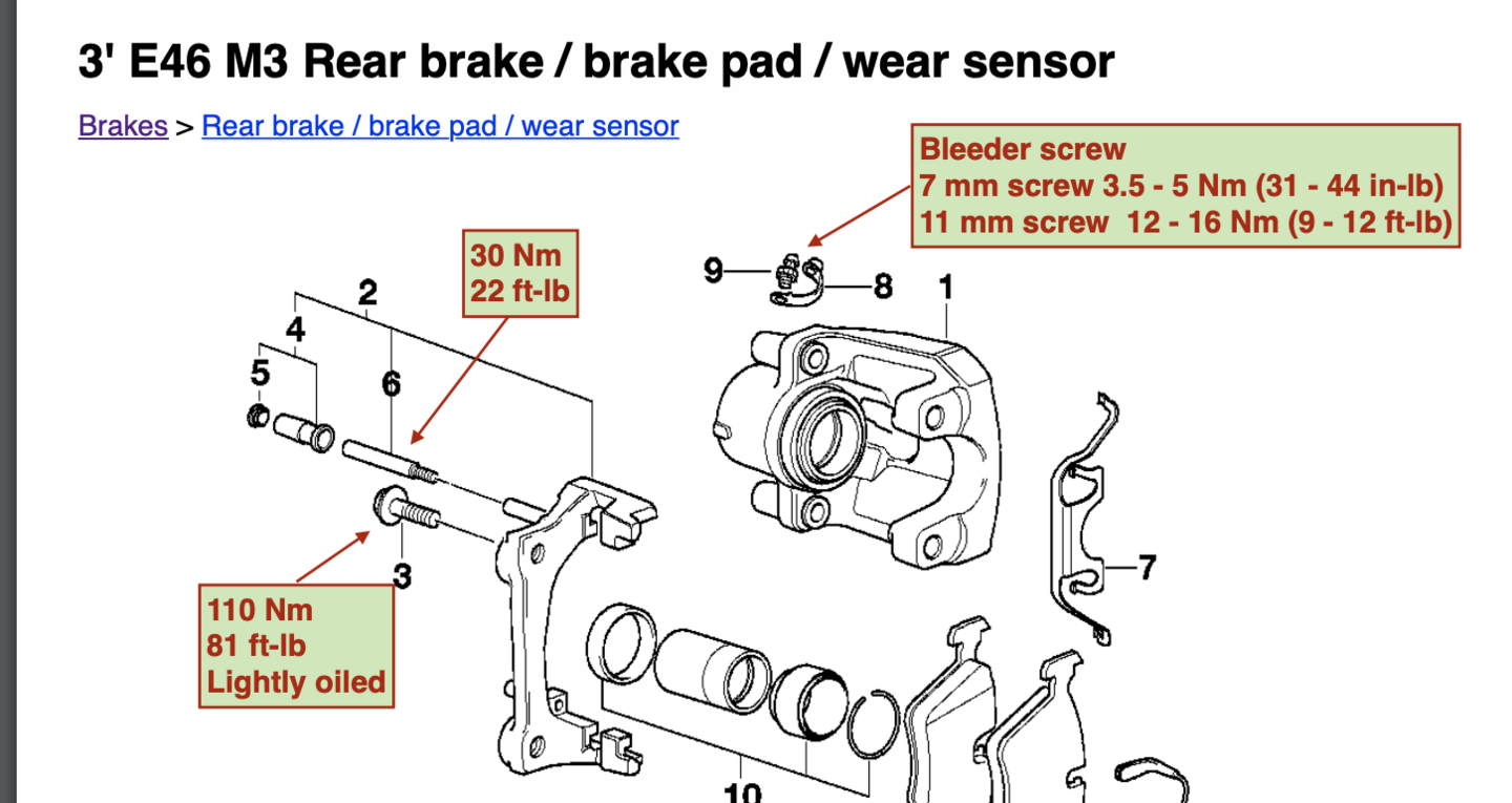

          The one reposted on this forum, which says it was created by Flow. It lists 81ft lbs. Maybe it was updated at some point?
          https://nam3forum.com/forums/forum/m...ar-on-diagrams
