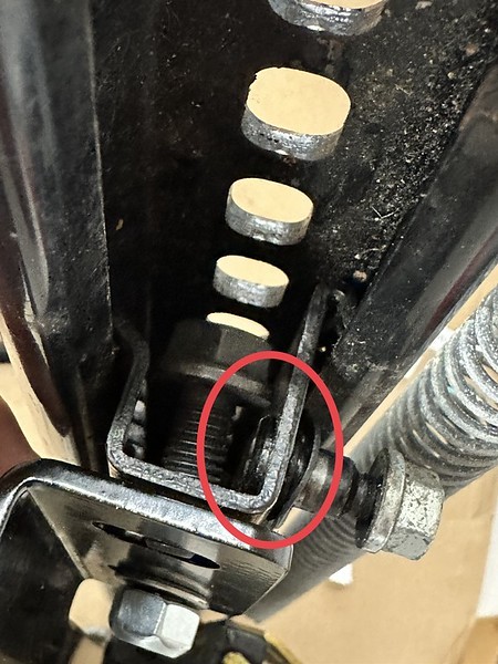

    Hmm, makes sense. I think your other picture made it look like it was further forward than it actually is. Much less concerned after seeing this new pic.
    I see the sub bar is already made to mount it somewhat far back. I'm guessing it's designed to sit as far back as possible before interfering with other parts of the seat/rail, so yeah maybe mounting it further back isn't feasible.
    Oh and good point on the ASM with the quick fits. Guess that for quick fits, the main purpose of the sub strap is to keep the lap belts on your hip bones and not let them ride up. Sub strap angle is probably a bigger concern with regular harnesses without the ASM thing.

    Here is a rough top view with cushion removed. It is close to vertical, you can see the bar there.
    It is not in the "perfect" 0-20 deg range, but it is close to 0. It does somewhat rely on the seat's front of the opening to bring it in closer to you, and to quote the instructions to enable "tangential touching of the chest and groin". I also think that mounting requirement of 0-20 deg back for 6pt is for preventing submarining, but since quick fits are "street" versions and have ASM built in, it is a bit less of a concern.
    I don't think mounting the subbar further back will work unless you notch the mounting holes (also not sure of interference because seat bottom really curves down for your butt and seat cushion). There are 2x holes on the subbar per side and they attach on the same mounting location where the mount attaches to the slider.
