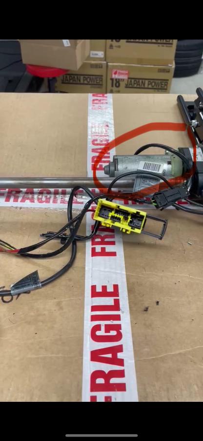

    The farther rearward (like the factory is) that the seat is mounted on the brackets, the more clearance you get underneath because of the rake angle of the seat. I found the same issue when I purchased BK mounts for Recaros - they mount them too far forward so that there’s no motor clearance. The solution is custom brackets.

    Interesting, I am using sedan manual seat rails, looking closer at your photo do have have the power rails? They sit lower I do believe.
    You could try the R-9220 mounts as well, they work and may give you more options. I would contact Brey Krause about that to be sure.
    Correct, it’s powered. I’ll definitely reach out to BK.
    I just don’t see how I can get the seats lower. As long as the motor is there, the seat bottom will come in contact with it if I go any lower - regardless of which mount I go with.
