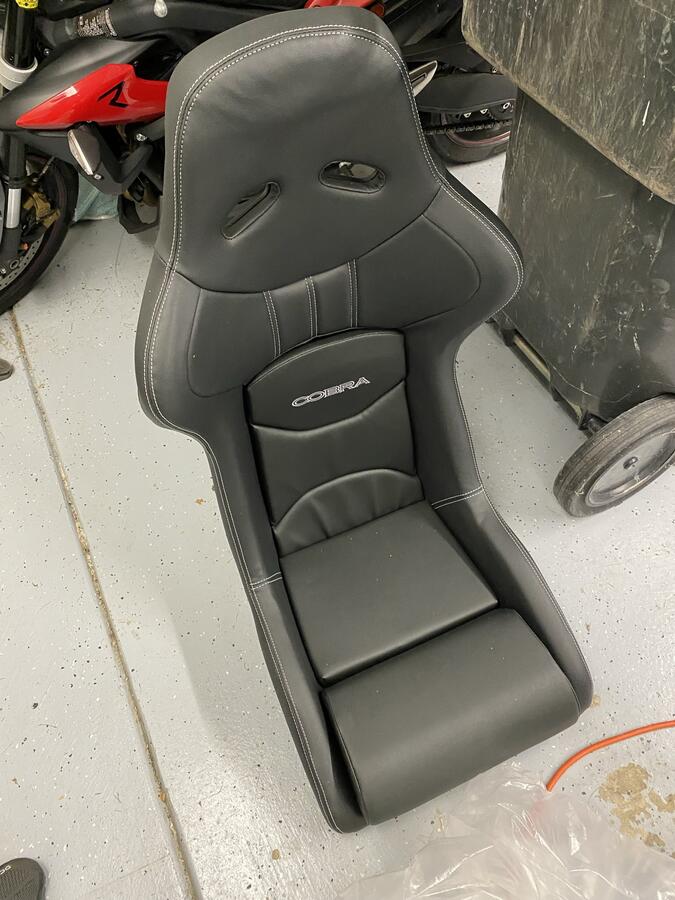

    Pretty spectacular, in my opinion!
    Seats are a project I have been pondering doing on my car for over a decade. In that time, I’ve run a bunch of different seats in different cars (specifically Sparco Evo IIs, Recaro SPG XLs, and Recaro Pole Positions) and found them all to be unacceptable in a street driven car for a variety of reasons.
    I view my car as a tracked street car. Every modification I do to it is done with that priority set in mind. That means I am not willing to do anything that makes the car less safe on the street (which lots of track focused seats do), less practical, or too much of a pain to hop in to go grab milk. In the context of seats, I want to improve the car on track as much as possible, without making it worse on the street.
    I also do not want to do anything that degrades the quality of the car. One of my favorite things about the M3 is that it is a high quality, well made object, which uses premium materials.
    Safety
    My primary concern was not making the car less safe on the street. There are two areas where traditional aftermarket seats negatively impact street safety.
    1. The factory 3 point receiver has nowhere to go. This is well exemplified in this picture of the Recaro SPG XL mounted in my M3 wagon (since removed):

    If you look at the Nogaros, you will see Cobra went the same route as BMW did with the CSL—the sides are low enough in the seat belt receiver area to allow the belt to pass over the seat, unobstructed. I don’t know of any other fixed back seats on the market that play nicely with the factory 3 point receiver.
    2. Many aftermarket fixed back seats have little to no head padding. This was true of the Recaro in my wagon above, and the Evo II I ran in my track car. For race/track use, where you are wearing a helmet, this is fine. For street use, if you get into a crash where you hit your head on the head rest (which is pretty much any front or rear end crash), it is a serious safety issue. Again, if you look at the pictures above, you’ll see that factory fixed back bucket seats always have head padding. On aftermarket seats, this is pretty unusual!
    3. The Cobra Nogaro is the ONLY fixed back seat on the market that is approved (by Schroth) to be used with a Quickfit harness. This is a huge improvement in on track safety over the factory 3 point in all crashes, and allows for the use of a Hans device (enabling further safety).
    4. For reasons beyond my comprehension, many fixed back bucket seats place the harness pass through holes too low to safely use, for an average sized person. It's like they're designed as a styling feature rather than an actual safety feature. The Nogaro does not suffer that-- no spine compression from too low harness holes here!

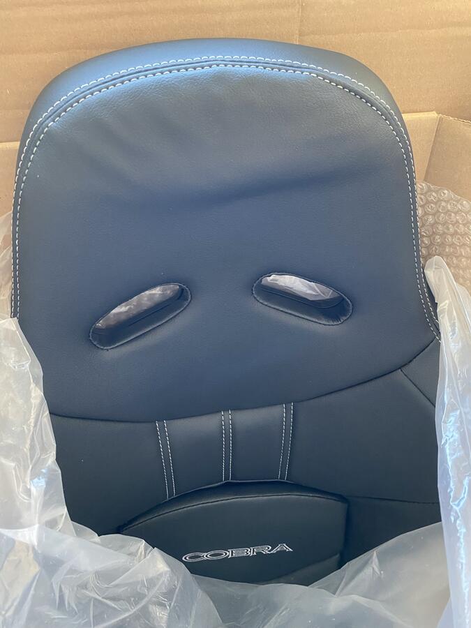

    Comfort
    1. The Nogaro has considerably more padding than any other non factory bucket seat that I have experienced (I’m starting to sense a trend here). This makes it more comfortable to sit in for an extended period of time. That said I had Cobra make me an extra thin bum cushion (that was there terminology for it on the invoice) specifically for track use—allowing me to sit lower, and have the side bolstering be higher relative to my body.
    2. The lower sides (which, again, I have only seen on factory fixed back seats besides these) mean ingress and egress are considerably easier. You do not need to have a strategy for getting into and out of the car—you just sit in it, and get out when you are done. When I had the SPG XL in the M3 wagon, my wife refused to drive the car because of the entry exit procedure. She prefers the Nogaro to the stock seats
    3. Adjustable lumbar-- In a fixed back bucket seat, installed by Cobra, at the factory. Different people need different amounts of lumbar support, and lumbar support is hugely important to how comfortable and supportive a seat is.
    Customization
    1. Starting with the obvious, mine were done in Imola leather with Imola thread. This was done by Cobra, at the Cobra factory, on their standard production line—meaning it is 100% factory quality/fitment. Cobra has a number of leather options, and is adding more, but, based on samples they sent me at the time, none were the 100% match to Imola I was looking for. I ended up getting samples from ~15 different leather suppliers before I found one I was happy with (thanks to a recommendation from Braymond141): Relicate. https://relicate.com/ . My experience with other seats makers has always been that they are not willing to work with you at all—any customization has to be done after the sale, by a 3rd party shop—more expensive and likely not as good as factory.
    2. Thread spacing. I actually didn’t even think of this on my own—it was Cobra’s idea. They had me take a picture of a tape measure held up against the stock stitching, and then matched it when sewing the seats—meaning the stitching on my seats has the same spacing as the stitching on the door cards/stock seats. A small detail, but also completely awesome, in my opinion!
    3. Factory BMW e46 seat heater pads are installed in my seats (also installed by Cobra)! This means they are plug and play with the factory seat wiring harness, and work with the factory seat heater controls in the center stack. Great for brisk spring/fall track days, first thing in the morning, with mandatory windows down!
    4. Extra, thin bum cushion. I had Cobra make me an extra bum cushion (their terminology) which is just a piece of neoprene—wrapped in Imola red leather, with BMW seat heater pads. This allows me to sit lower and have more side support while on track, similar to a more track focused bucket seat.
    5. Seat occupancy sensor. This is something I didn’t choose to do, as the BMW occupancy sensor tends to be unreliable, but something they were willing to do (so I thought I should mention if others wanted it)—they were more than happy to install this, at the factory, as well. I opted to not get it, and coded the errors. The downside to my approach is that the passenger airbags will go off in a crash, whether there’s a passenger in the seat or not—making a crash more expensive.
    6. Adjustable lumbar support. As mentioned above (in the comfort section), I have adjustable lumbar support in my seats. This can be adjusted on the fly by a small hand pump/release valve that I have tucked inside the leather on the tunnel side.
    7. The shells are offered in GRP (22 lbs seats) or CF (12 lbs per seat). I opted for GRP because of the price difference… which I might regret one day (I could have had an additional 20 lbs of weight saving with no detriment to functionality/comfort).
