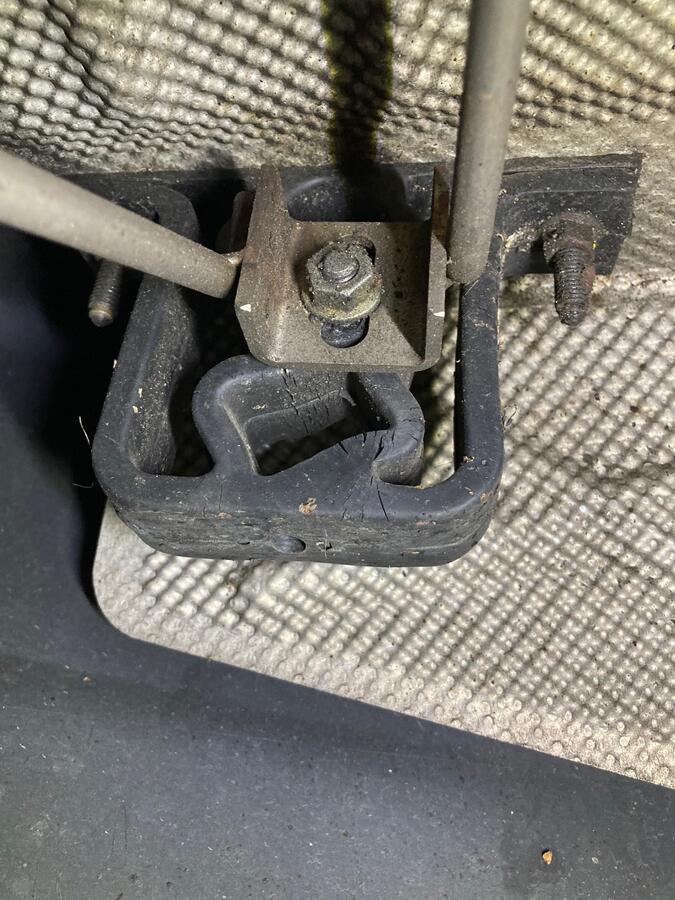

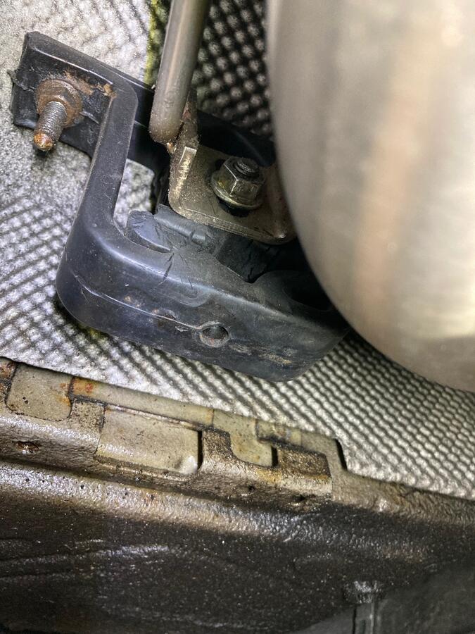

    Lastly, my new OE muffler hangers (HJS brand) have pretty much failed within a year - don't buy! I'm not going to hope for a little more life out of OEM ($50 ea), so I just placed an order for Rogue's

    Click image for larger version  Name:	IMG_5986.jpg Views:	0 Size:	108.4 KB ID:	121105
    Click image for larger version  Name:	IMG_5987.jpg Views:	0 Size:	115.6 KB ID:	121106
      Brand new OE exhaust mounts will last a while. There is the OE metal bracket that was not transferred over to those aftermarket mounts. It give the mount a little more structure.
        Yes-- those mounts are incomplete.
          Ah. FWIW, I'm only seeing a choice of OEM or aftermarket (HJS) these days.

            I didn't fully comprehend Slideway's comments - now I get it. You mean this, separate bracket

                The HJS are of good quality, but yes, slip them into the OE bracket.

                  These exhaust mounts are notorious for tearing and yes it's a two part system.

                          Tough pill for sure. Even more egregious if they're galvanized, which is what Rogue's site suggests by noting prone to rusting.
                          These brackets weren't on my vehicle when I purchased, hence the mistake of just replacing the mounts. Besides maybe keeping some of the lateral movement at bay, which could reduce the stress, I don't understand how the added brackets have a meaningful effect. Its not like the brackets provide any droop support.
                          Does anyone know why the factory mounts are so elaborate? They appear designed to take a lot of movement. Rogue's mounts (which I'm committed to trying) eliminate it.
                            Lots of expansion over the length of header to muffler when things get very hot?
                              Ya, that, and I would imagine that the metal just simply provides support to the rubber portion (so as not to over extend/deflect)...similar (to a lesser degree) to any suspension joint where the metal housing encapsulates the softer bushing inside.
                                I’ve observed the system extends 1/4 to 1/2” inch doing a visual on the tips. And a quick look at the coefficient of expansion for stainless indicates a 3 meter length should grow 15mm over 300C delta (a guesstimate for the average increase).
                                Probably what I’m missing is I’m just doing street driving. Perhaps during track driving that temp delta is higher.
