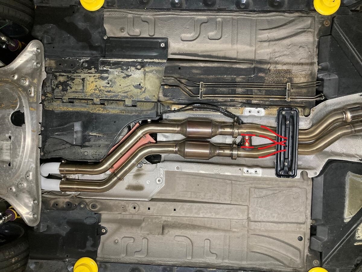

                  Im curious what this pink'ish pad is, a heat shield add for the trans mounts? If so im interested, since the added heat from the exhaust can/may serve to dry out rubber bushings on the transmount. jbfrancis3
                    #54
                    Yep, for the transmission as a whole including the mounts. The exhaust runs close and the heat radiation is intense. I figure why further thin my trans fluid which I need for dampening with the SMF!
                    Just a general heat shield meant for one pipe, but the mounts on either side happen match the spacing of the dual pipes on this application. Size 6"x1'

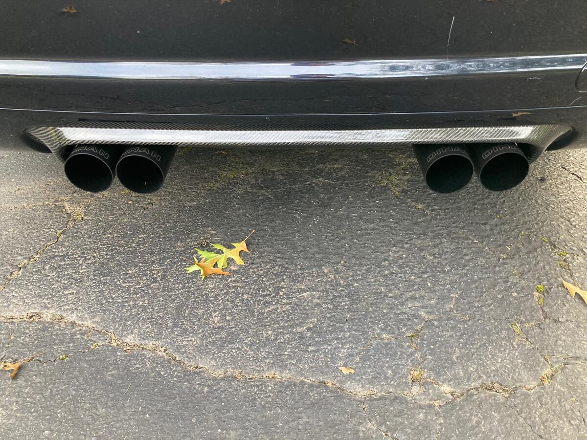

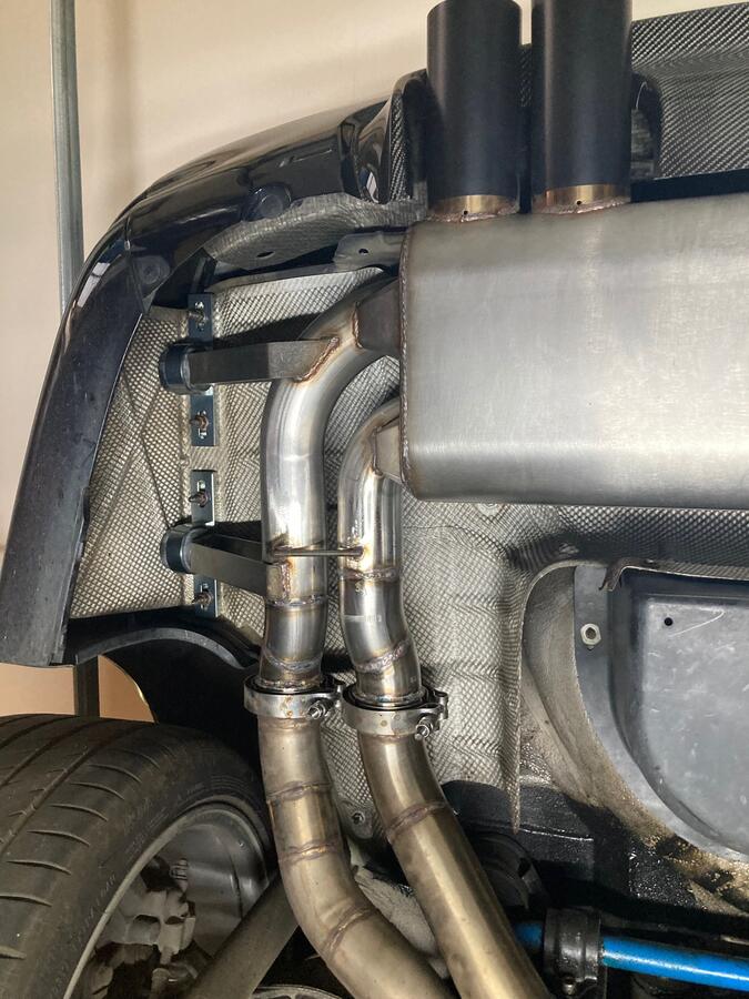

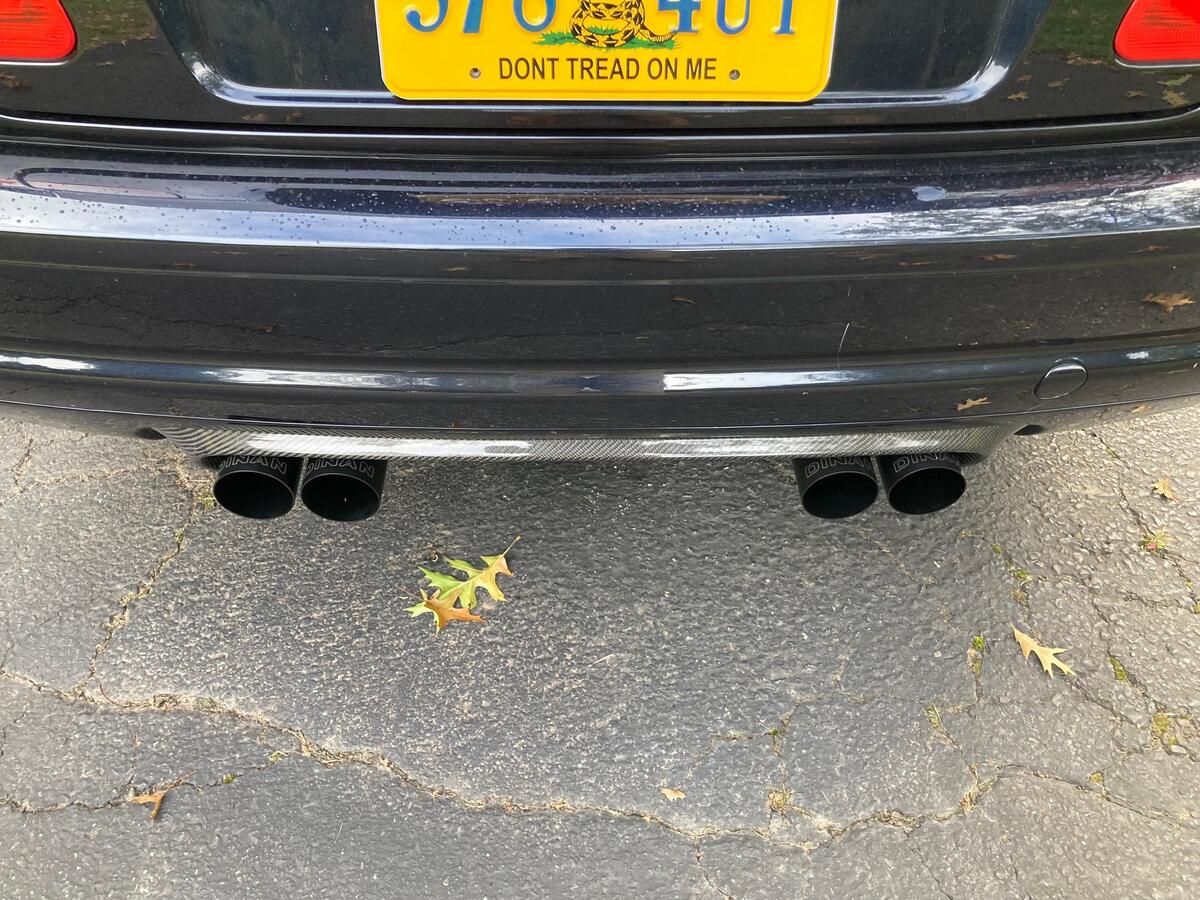

                              Next iteration is complete with the Dinan section 3. It hangs from Rogue Engineering's exhaust mounts. I had to reduce the width of the Dinan mounts by 1/4" (by taking in the passenger-side single mount) to make everything fit nicely. This also set the exhaust dead-center of the CSL valence which was nice.
                              Early thoughts after one short drive is its a bit boomy down low. In the middle range and top end, its much more lively than the SZCA representing a big step in the right direction. Time will tell on tolerance for low-end characteristics.
                              With the entire system fairly rigidly mounted, I expected some undesired effect knowing the system lengthens when hot. It did not disappointed. No rattling but some odd vibration/resonance which I think is caused by the inner bush sleeve of the Rogue mounts pushing so hard that it squeezes out the rubber and contacts the bushing housing. Very noticeable and I don't want to continue stressing everything, particularly the headers.
                              So next up, I'll be installing some double slip joints somewhere in the system (not sure where). Flex joints would work but need more space which is something I don't have. Flex bellows aren't suitable for the application.
