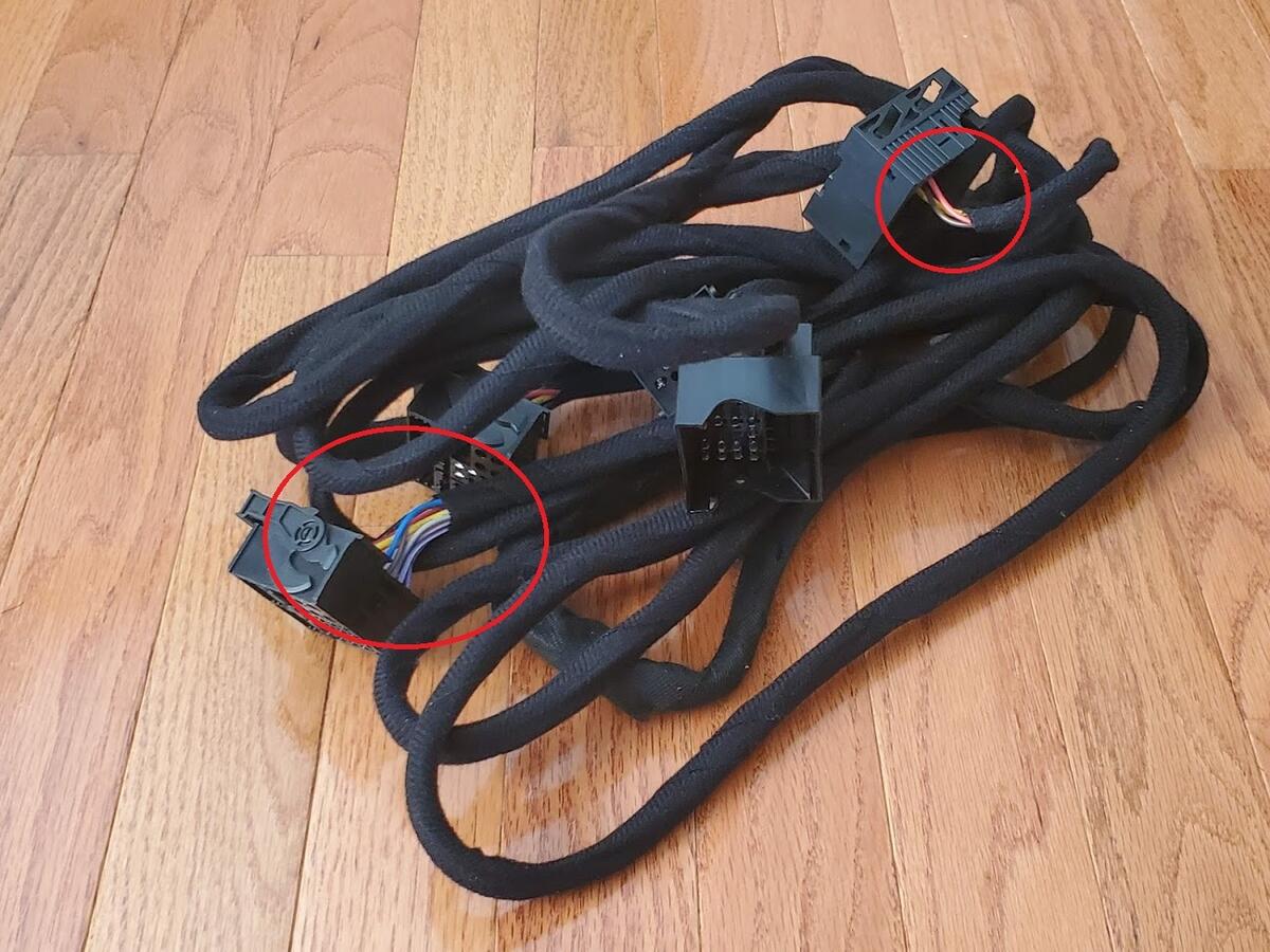

    I had a similar issue, except I had no sound at all, look at the connections on the Farka cable very carefully. I gently tugged on each of these individual wires on the cable. The act of connecting the cable up sometimes pushes these wires out of the plug housing. It happened to me, and once I inserted the individual loose wire back into the housing I had no problems.

      I had a similar issue when I installed mine. Sound coming out of all speakers except 1. Unclipped the harness and tugged on all the wires and it was a pin that was loose. Once I seated it back in the plug it worked fine. Reminder to always test everything before you put it back together so you don't have to take it apart again.

          Mine was the end in the trunk, that plugs into the BMW harness. However, I think it is equally likely to happen on both ends. I would probably start with the end in the trunk first, since it is more accessible.

            Thanks, guys. Finally got around to looking at this again and it was a loose connection in the trunk harness. Glad it was the easy end of the plug!
