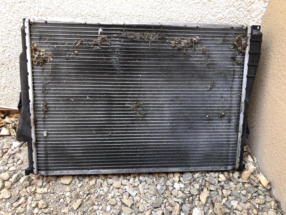

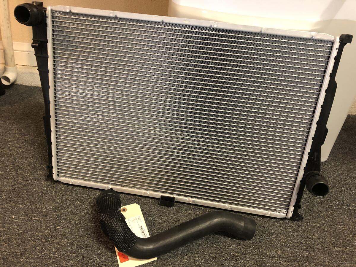

                    I finally got the radiator swapped out this week and order seems to have returned. Warms up to the middle and doesn’t move! The coolant was nice and clean coming out but it must have lost a lot of efficiency.
                        Excellent. Still investigating mine
